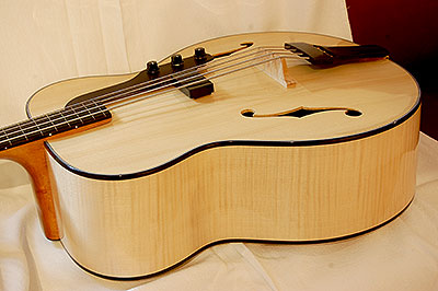

I found this good looking little instrument at http://www.sonntag-guitars.com/english/ ... c-Bass.php it has given me some ideas that I thought I would run by all the gifted and experienced builders here. First off, would a more drastic arched top allow for a slightly thinner more comfortable body without sacrificing volume? Could a larger neck angle, similar to an upright bass, allow for a taller bridge and thus louder, as well as a longer fingerboard OVER the soundboard and extending from the neck (i.e. as an upright bass)?
I guess what I am describing seems kind of like a cello with a guitar shaped body. Really all I am trying to do is figure out how to make an acoustic bass instrument that is more portable than a doghouse bass and louder than the typical flat top acoustic bass guitar (no electronics). That is also not a guitaron.
Ideas?
Ideas?

The depth of the sides reminds me of the Ernie Ball Earthwood basses. The reasoning is a larger air chamber can support a lower frequency than a smaller one. Sorry but so far I haven't seen a bass guitar that can really carry it's weight in an acoustic jam. I'm not saying it's impossible, but I have yet to see one.

I converted a gitaron to four strings for a friend who plays in a bluegrass band. It's the only small acoustic bass I've heard that could hold its own and blend with the band. It was a long time ago, but I believe we excluded the low "E" and added a "B" on the treble side. He's still using it.
This pretty instrument has a pickup for good reason!

I played a few notes on a Ribeckke Halfling bass and it was pretty loud (and sounded good, too). I saw some footage on an archtop bass he is building for Jack Casady and I suspect it will be pretty loud as well. But nothing is going to make it as loud as a decent double bass. None of the "violin" family instruments are large enough to produce the fundamental of their lowest string (or so I've heard) so a guitar sized object is already at a disadvantage.

I built a very successful (in my opinion) acoustic bass guitar. Since the body couldn't possibly be big enough to carry the low notes, I built it to accentuate the second harmonic and counted on the ear to fill in the missing fundamental. It pretty well worked. When we did an FFT on my upright bass, the fundamental on the low E string was maybe a third of the height of the second harmonic on the graph. The FFT of the acoustic bass guitar showed almost no fundamental but a second harmonic twice as tall as that of the upright bass. To the ear, both notes sounded very much the same. But, that note was quite loud in the room no matter where you stood in reference to the upright. With the bass guitar, the note was loud when you were in front of the bass, not so loud when behind. To get the strong second harmonic, I made sure the bridge was above the center of the lower bout and made sure the saddle was at least 1/2 inch tall. It required a pin bridge to get ghe rocking bridge motion that would drive the second harmonic on the top. I don't think it can be done with a floating bridge and a tailpiece.

Tighter strings mean the top has to be stiffer to support it. A stiffer top can mean less vibration. Lengthening the scale may decrease the loudness, not increase it. For an acoustic bass, more volume in the body will help with the perceived fullness of the lower notes. In this case, as big as is ergonomically possible is probably right. But, again, you reach a point where the stiffness of the top required to support the pull of the strings over the longer span of the bigger top starts to work against the loudness.
