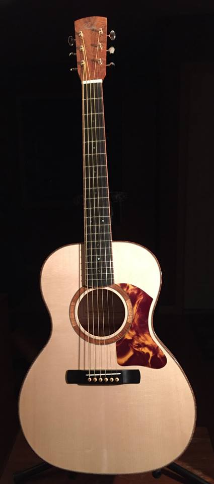

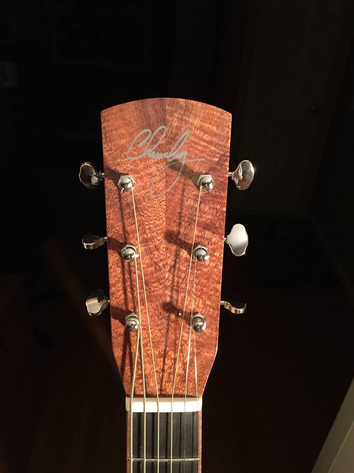

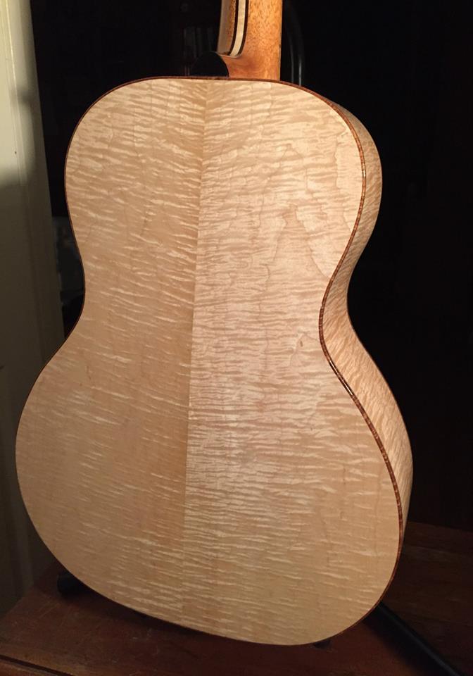

This is my fourth flat top. It has a red spruce top, maple back and sides, Mahogany neck, and Koa bindings and peghead overlay. It has a very nice balanced sound. Great for finger picking. Good with a flat pick too but not nearly as powerful as the rosewood L-00 that was my second build.

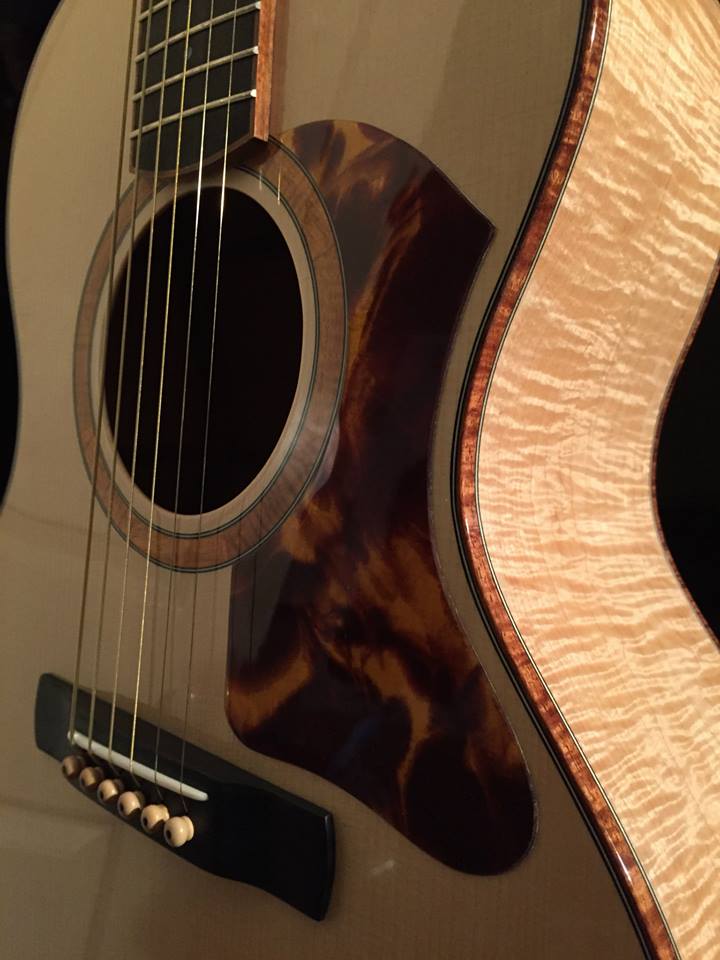

Now the bad. When I set the bridge I somehow shorted the scale enough that I couldn't compensate by filing the saddle. I routed out the 3/32 slot and replaced the saddle with a 5/32 one but that still left strings five and six sharp so I had to remove the bridge. My normal bridge setting procedure is to measure and mask the top for the bridge and then when actually gluing on the bridge I use a temporary tailpiece and set the actual bridge/Saddle using a tuner to get the position right and tape it off so I can replace it exactly. It's pretty fool proof but as I'm an ugly fool I managed to beat it. I think I might just sand down the top and refinish due to some dings and marks I managed to put in the finish.

You can gain some room on a same-size bridge by putting the bridge pins at an angle(rearward...). This would allow you to set the saddle further back, and might be all you need.
