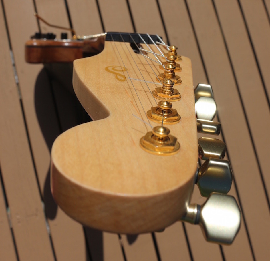

2 piece maple neck angled headstock & zero fret.

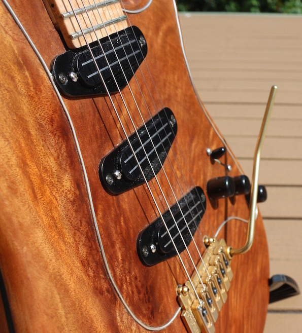

Lawrence E45 (I think) pickups, Sperzel tuners,Wilkinson trem (using tremsetter)
Wiring is : volume with push/pull to straight to amp
2 tone controls which both work on all pickups.
One has min roll off for rock playing – with 2nd full on
The second a lot roll off for jazz type playing. (with 1st full on)
But honestly , the most pleasing result is with both tones full on and just rolling off a wee bit of volume.

Really Nice!! took a moment to realise there isn't really a pickguard but rather an outline inlay (maybe not the right word). Those Lawrence pickups are fantastic as well.

At what angle is the headstock pitched back?

Thanks guys,
Headstock is tilted at 13deg IIRC - whatever my jig is lol.

Really nice work, Robert! I for one really like the looks of a 6 in-line headstock that is angled. No need for string trees, which I always find clumsy and cluttered looking. John's post above has me wondering about that pick guard (or not?) on this guitar. Can you tell us a bit more about that? Again, really nice work!

Talk more about your electronics:
- So, when you pull the volume up, it sends a raw, full-volume signal straight to the amp, bypassing the tone controls?
- Two tone pots, and they work additively (e.g., the first pot gives you ~50% roll off, and the second 100%)?

I'm curious about the "No" pickguard, or "Yes" pickguard?
Also curious about the tone controls.

no pickguard - John saw it above...silver wire 1.5mm inlayed into the outline.
re the wiring - Jason is right on the push/pull and the other aspect is better expalined here :
http://guitarwiring.blogspot.com.au/201 ... .html#more
I liked the idea and added the push pull - it works as stated, but as I said the configuatioon i end up using is both tones full on and volume rolled off a bit. That sweetens everything and I can pull the vol up (from anyhwere ) for solo & push it down when finished.
At some times I just roll the second tone right off. Ususally one is left full on & the other used for differing degrees of adjustment.

I went searching for such wiring/mods and found a couple different versions of the bypass. From the various discussions of a bypass on the various forums, it looks like folks usually go with a no-load tone pot: 1-9 sweeps the cap, then 10 clicks and is wide open. Clearly you have the configuration you want on this machine, but I wonder if you could place a no-load pot on the first tone and get the same effect as the pull on the volume to bypass.
And those are mini-buckers, right? This thing sure is quiet then, huh?
Oh, and the pickguard outline is clever! I thought it was clear lexan and what we were seeing was the unpolished edge.

you got staggered tuners?, isn´t that redundant with the headstock angle?

...carefully calculated failsafe strategy ..neither a sudden change in neck angle or change in length of the stringpost will affect stringbreak tension over the nut and zero fret. If both happened simultaneously i would be in trouble!! But I reckon the odds of that happening are quite low.
