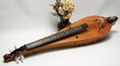

I make bowed dulcimers and I need to find a source for ready-made hard cases. I have searched the internet up and down for a simple but, alas, elusive answer: what is the total dimension -- tip to toes total, not just body length -- of a 1/2 size cello or a large viola case. I get tons of charts but never a simple answer. My dulcimers are 36"long; 9" wide; and 6" thick from the back to the top of the bridge. Any ideas?

Here's how my basic bowed dulcimer looks like. The dimensions are in my previous post. I have already made a wooden case that weighs a ton, but I'm still hoping for something a bit lighter and more elegant than a crate with a handle.

" I have already made a wooden case that weighs a ton, but I'm still hoping for something a bit lighter and more elegant than a crate with a handle."
The problem I've found with many home made cases is that people build them too heavy. I have copied some of the old "coffin cases" guitars and fiddles used. They were built with 1/2 inch pine or poplar sides and thin plates top and bottom (I use 1/8th inch (3mm) plywood). These cases are reasonably strong, especially if you put a slight arch in the top. They can be snapped together pretty quickly with titebond and a brad nailer. I line them with velvet covered corrugated cardboard, which gives some padding without adding too much bulk. Some of the originals used paper glued to the insides.
Strength -wise I wouldn't rate them with a "road case", most of which are very heavy, but for giving protection from the environment and typical bumps and scrapes they work fine.
P.S. - Very mice looking dulcimer!
