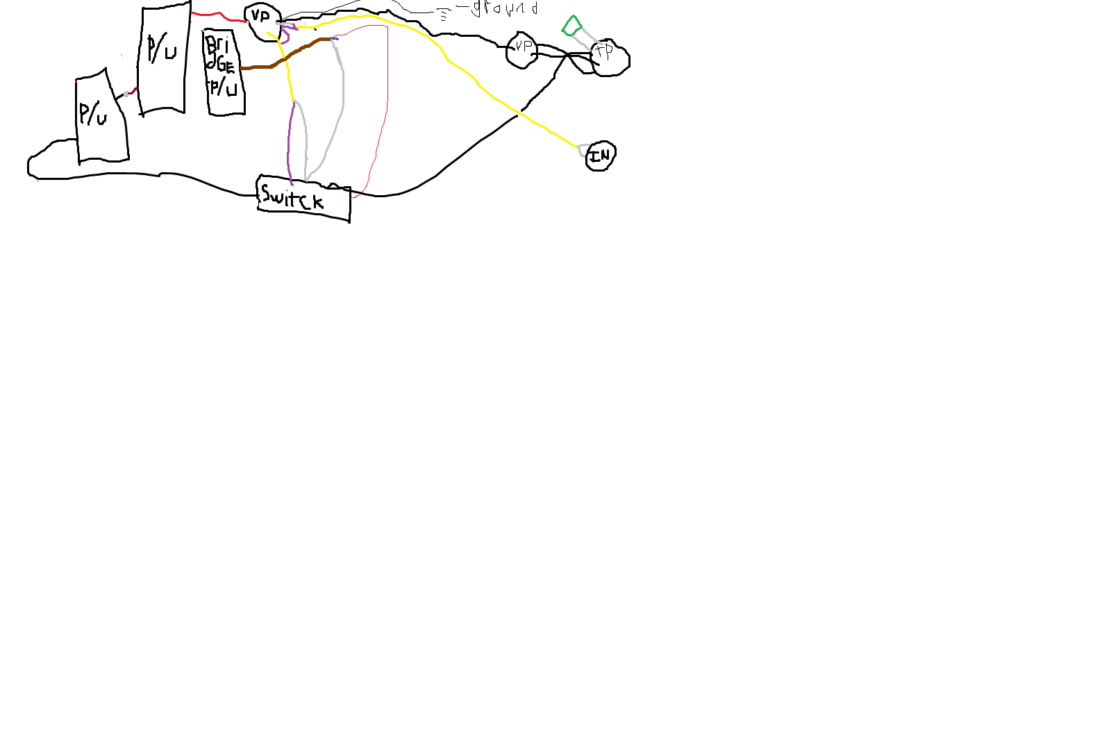

Fast forward to today.... The guy who gave me that bass wanted it back for his church... Seeing as he was nice enough to give it to me and let me have some enjoyment out of it I gave it to him and got a Kawaki K1 synth and a not working but in good cosmetic shape Vantage Bass. Ive got it all apart thinking that I just needed to resolder a connection or something but everything inside looks to be good. There is one blue wire coming from the bridge humbuckingish pick up that ends at the end of the large shielding wire that contains the rest of the wires from this pick up that doesn't go anywhere, and has no wire coming out of it.
So my question is.... Why isn`t this bass working? Fried pot? Bad switch? Pickups dead?
Ive attached a very poorly made wiring diagram of how it is now. All wires are colored correctly except for purple which is a white wire. Also note the little blue stub coming from the brown wire from the bridge pick up.
Hope some one can help me
Thanks
Bob

Post by Bob Siemens »
Oh and the green thing on the tone pot is a cap.

Well Bob, if it's wired anything like your diagram, I'm not at all surprised it's not working!
Sorry, but your diagram is completely indecipherable, we're not going to be able to help out without something more clear to work with. It looks like you've used MSPaint, if you don't have a better graphics program, could you try using the various shape tools (square, circle, etc) rather than free-hand? It's more likely to result in something legible.

The drawing is funny - it looks like a map through a graveyard.
I would start troubleshooting this by bypassing one of the pickups and seeing if the problem still exists. Then if you still have issues - try bypassing the volume and tone pots and see if you get any response at that point. I am not a real electric guy anymore - but that is all I can tell you of basic troubleshooting, eliminate parts to test and get back to basics.

Your drawing indicates only one wire from each pickup. Is that correct?

the neck pick ups have 2 wires each coming from them one from each conecting them together.

Re: Vantage Bass Guitar
Bob, Your bass should be wired like a Fender jazz bass, but with a selector switch. I've tried (in vain) to upload a schematic, but my skills are lacking (Files are too big). Send me a PM and I will send you some diagrams "off line".
If time is tight, you may just want to take this to a tech.

Actually the picture you drew is pretty clear if I'm understanding it correctly. The colored wires (yellow or brown) are shielded and they split into a hot (red or purple) and ground.
You have a three way selector switch, a "P" type split pickup and a "J" or soap bar pickup.
I'd start with the jack as that's where most problems are.
Make sure the nut that holds the jack in is tight, same with the pots who's nuts reside under their knobs.
