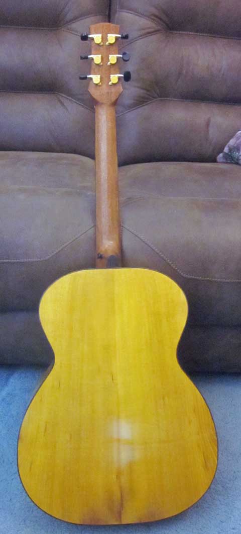

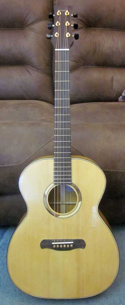

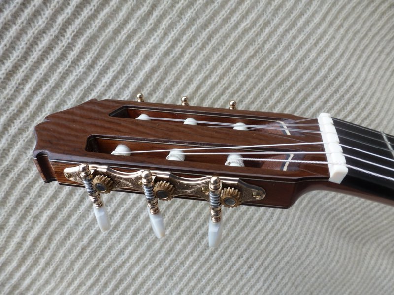

Instrument #100 just got its strings (and it sounds pretty good, too). This one has Osage Orange back and sides, an Engelmann top, Macassar Ebony bridge and fingerboard, EIR peghead and bindings, and a Khaya neck. It's my Rappahannock model, about the size of an OM.
It's been nearly 23 years since #1.-

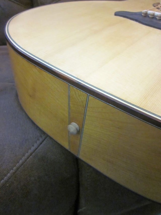

Are you sure you didn't buy that one? I don't see any neon yellow dust anywhere in any of the pictures <g>.
She really has a beautiful shape to her. Nice job on the design. And thank you for mitering the black on the end graft, that always drives me nuts when it just chops across the top. Really nice guitar.

Thank you all for noticing. To answer Len: There isn't one thing that I've learned. It seems like there are hundreds of them, many things learned again many times. I cheated on that end graft mitering. I ran the purfling all the way around under the binding. There where it met the tail, I drilled out the black and inserted a white piece. If I can't find a simple way to do something, I usually can't do it.

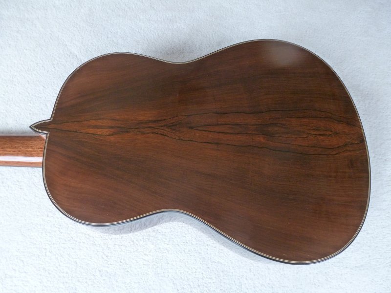

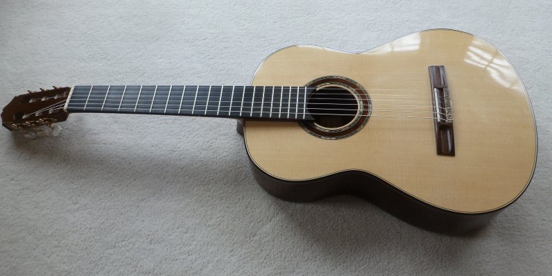

Exquisite work. I built my 100th in 2012. Spruce top, 40 year old flitch matched Brazilian Back/Sides, Spanish Cedar Neck. The client named it "Assegai" as the pattern on the back resembled the hand made blade of an assegai which is a short handled spear used by the Zulu's in their wars during the 1800's and early 1900's.
