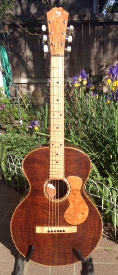

Hi there;
I built a small bodied L1 style some time back that was all Walnut. I like it a lot. I nick named the walnut "California Koa". I also built an all walnut Weissenborn as well. Very happy with both.
John

- Posts: 497
Re: Walnut soundboard?
Nice looking guitar.
Is that maple for the fretboard and bridge?
I didn't think anyone else was doing that on acoustics.
Thank you.Rodger Knox wrote:Nice looking guitar.
Yes, maple bridge, FB, pickguard, and neck.
