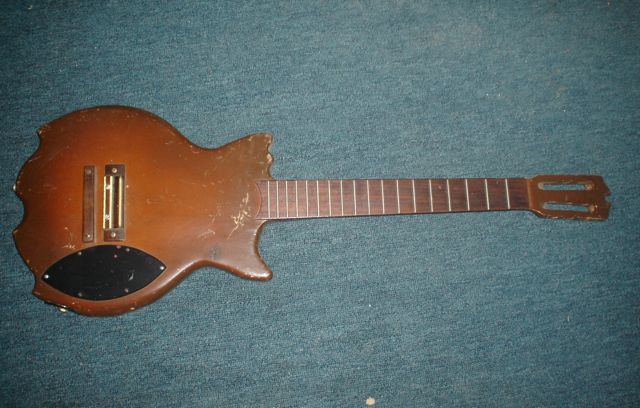

The first guitar I built was a solid body nylon string guitar back in 1972 or so. I used the neck from a cheap classical guitar that had come loose when my older brother made the mistake and put steel strings on it! The body was made from pine. My plan was to use two Barcus Berry hot dots, which had just come on the market. But being only 15 at the time I didn't have the funds for them, but later stuck a piezo disk under the bridge which worked pretty well.
I just used the bridge from the host nylon string guitar. Later I added a tailpiece as it seemed to get more volume from the piezo because the brisge wasn't being twisted back to front. The bridge is not glued to the body, but held on with two screws. This was so I could experiment with transducers.
Here it is as it looks today...

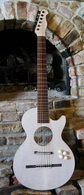

James this is my first nylon solid body. It has an Artec preamp in it but I don't remember which model. I was totally happy with the preamp. The piezo is in a handcrafted bridge that was made from three 1/8" thick pieces of rosewood sandwiched together. By sandwiching these pieces, I created a slot for the saddle and piezo and all I had to do was carve the exterior shape -- too simple. I made the bridge, found the intonation and alignment spot and then drilled the hole for the piezo wire -- its just hidden under the bridge. The tailpiece is a cut section from a standard classical guitar bridge -- too lazy but it works. Guitars like this can be a very inexpensive build and very rewarding instruments.

Very cool build Mark. Aahhh....I do have one question. Why are the fire place bricks showing through the sound hole?<G>
