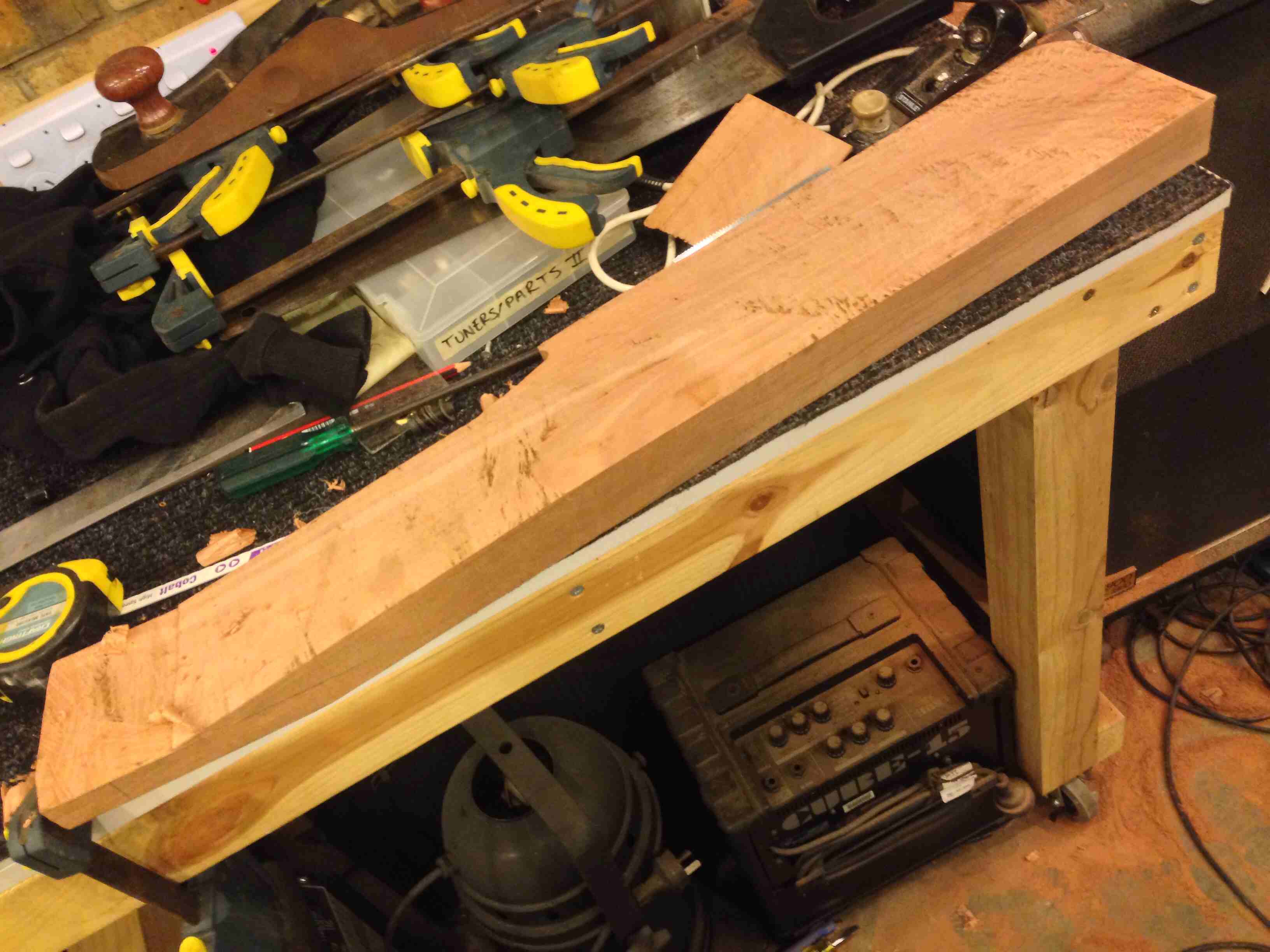

He had some Queensland Maple left over from his neck blank, and asked if there was anything that I could do with it. Here's a picture:
As you can see, it's slightly oddly shaped, and there are some indexing holes that I would have to work around. I could probably build a couple of necks with it, but thought I might try something different. I had a think and played around with the dimensions in a vector program to see what I could fit in the available blank, and thought it would be perfect for a 6 string lap steel.
I've never played a lap steel before, so this is certainly something new for me.
I decided to aim for about a 21" scale, and tune to a low C6; I wanted to be able to play in a lower range than an E-standard guitar, and it's my understanding that lap steel C6 is generally tuned to c 130.8Hz, so I decided to go with C 65.4Hz tuned low-to-high C E G A c e with 52w 39w 32w 28w 22p 17p strings which should give me a pretty evenly progressive tension from treble-to-bass, which is something I much prefer than any of the off-the-shelf string sets for guitar from the major manufacturers.

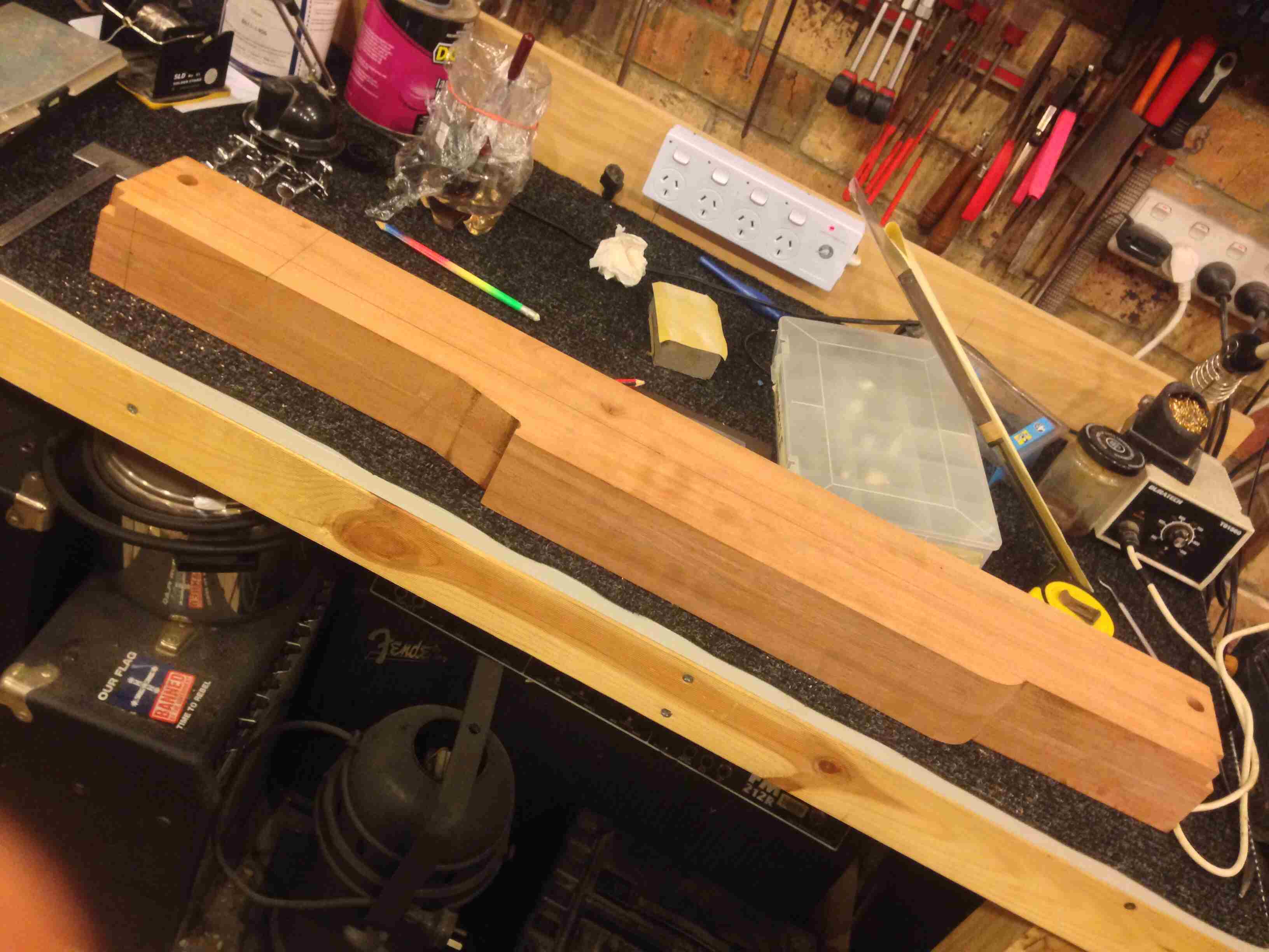

Anyway, onwards and upwards. Here you can see the first cut I made in the blank after I had leveled some of the surfaces a bit with a jack plane.

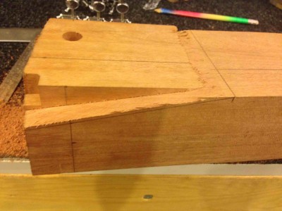

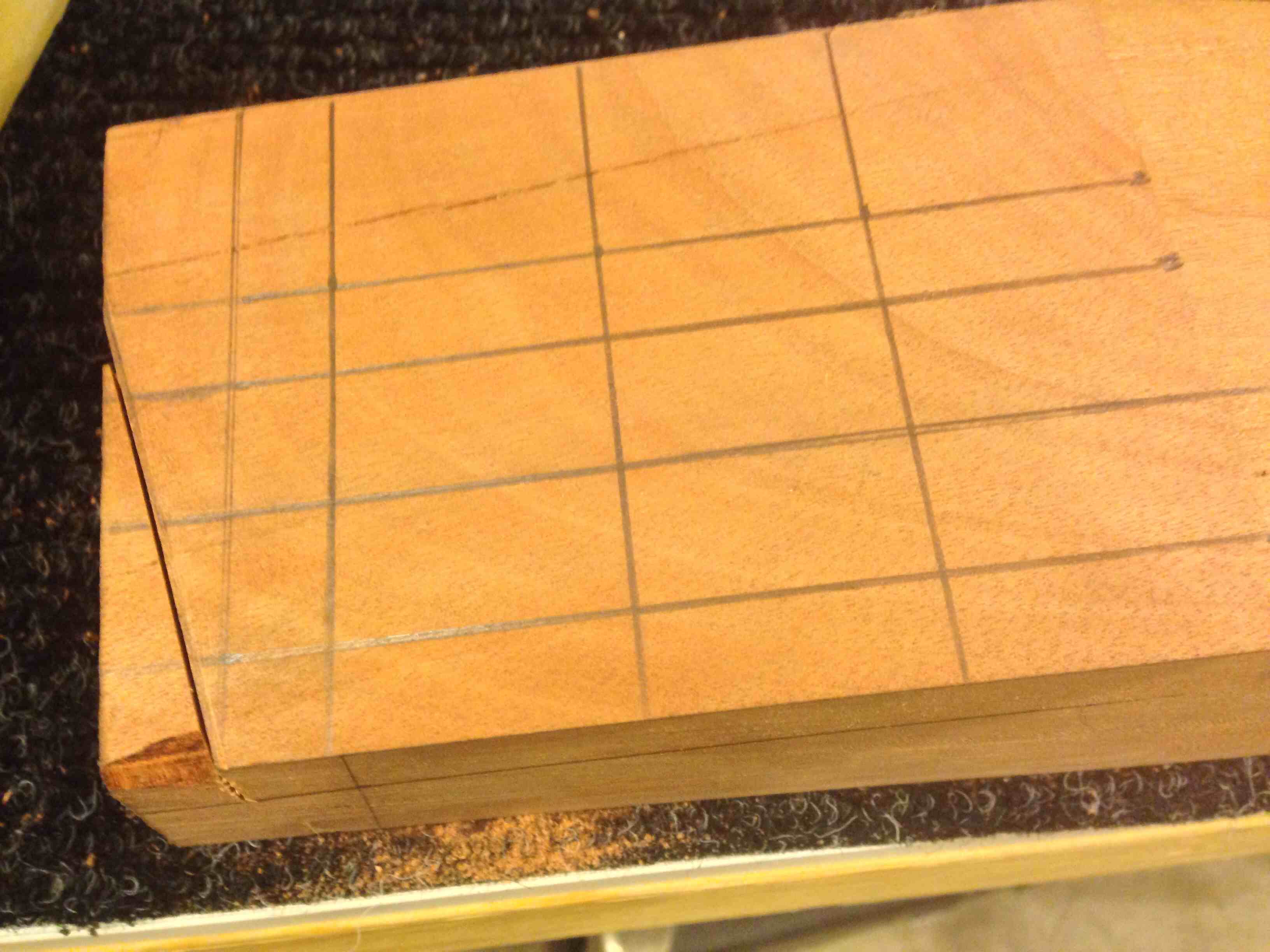

I shortened the blank where it became narrow, and this will be the bridge end of the body.
Here I eyeballed about a 10° angle.
My saw didn't stay perfectly on track, but it wandered to the outside of the cut. It just means a bit more work with 62-1/2 block plane.

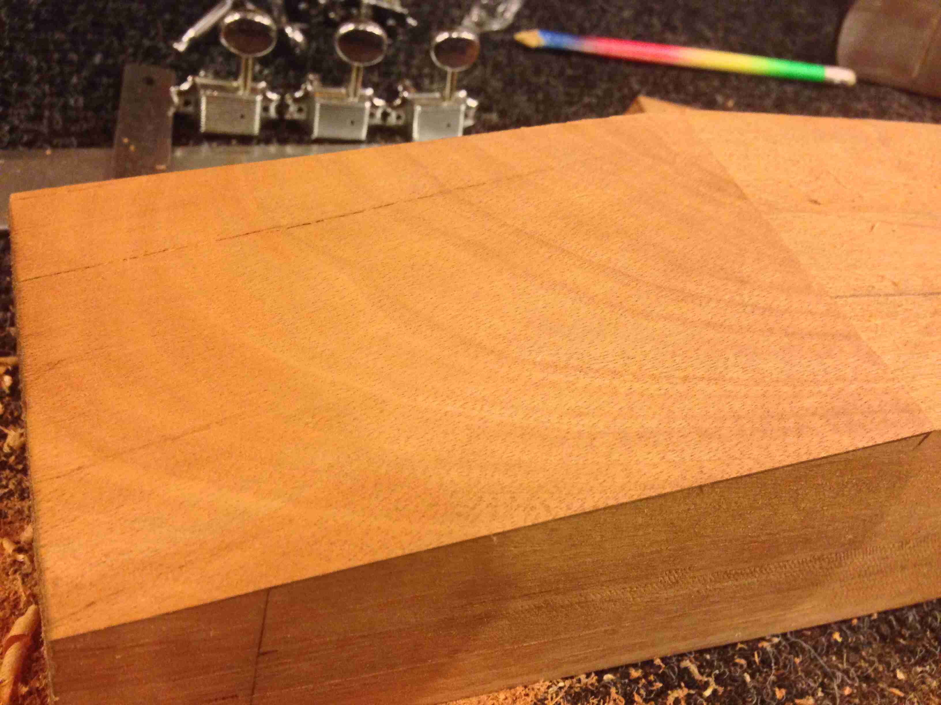

Here's the surface leveled, and you can see some checking in the wood that wasn't previously apparent. Fortunately it lies outside of my planned layout.
Time to bring the body down to thickness. I need a bigger bandsaw!
It took about 30 minutes to resaw through the whole blank. Pretty tiring.
And here you can see the ugly result. I don't do much in the way of building, as I'm doing full-time repairs for guitars and amps for a living, so I'm not particularly well set up for large-scale wood working. But I can certainly get the job done with a bit of patience.
This will need a bit of cleanup with the jack plane.

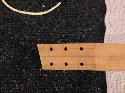

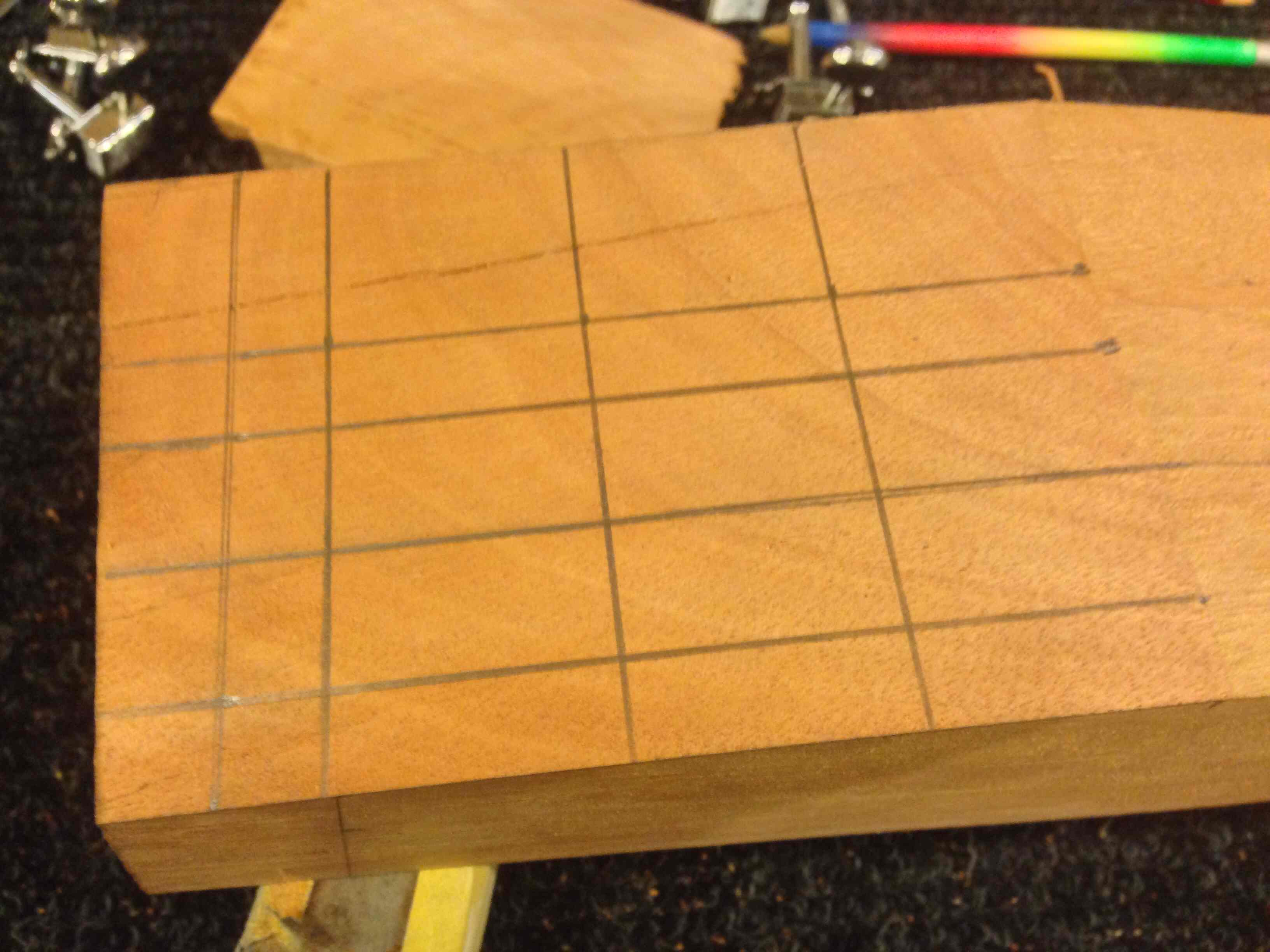

I was originally planning making this a slotted headstock with vertical tuner buttons, and here is some basic layout work. As you'll see later, I changed my mind.

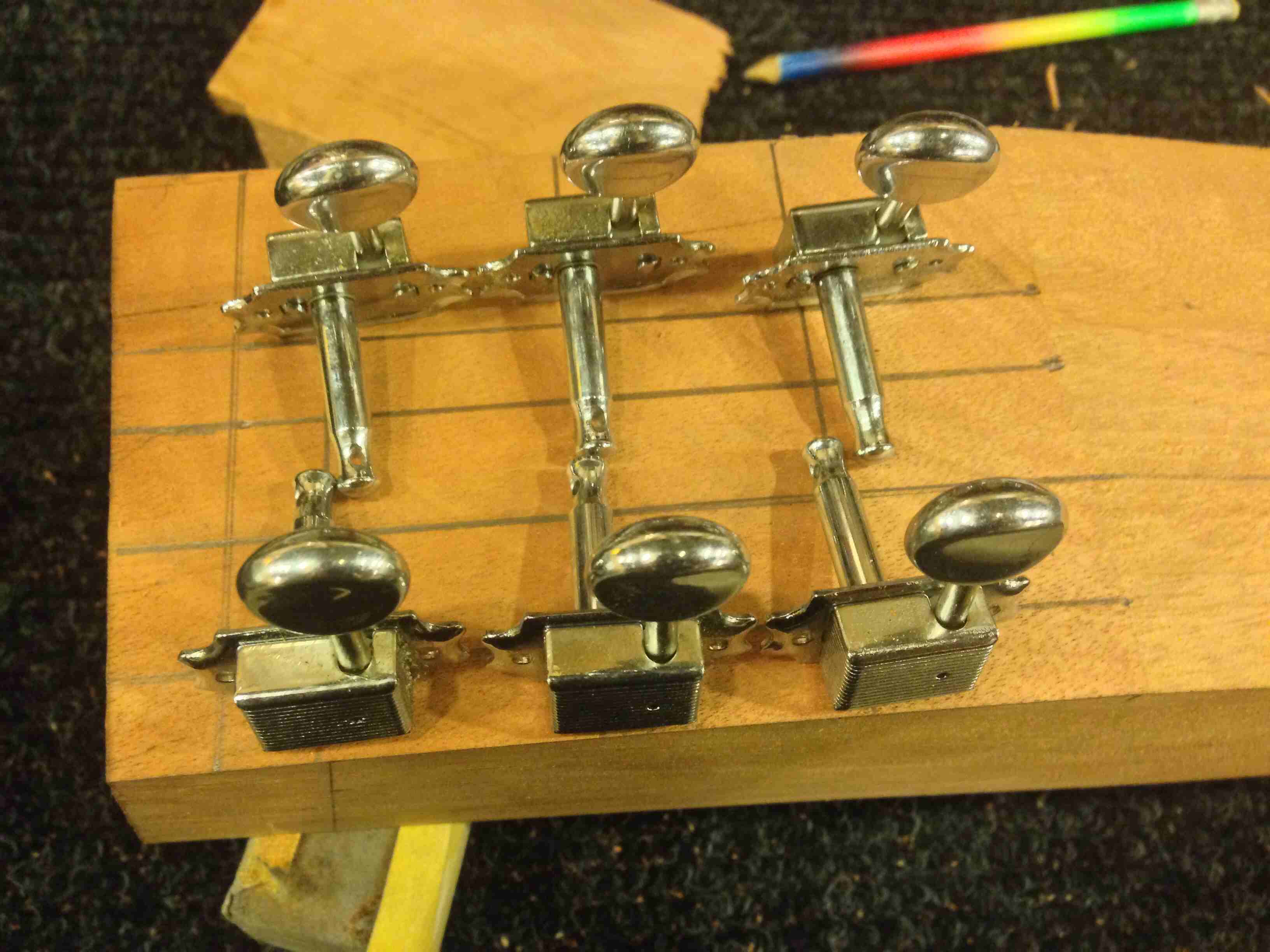

And here are the tuners and basic orientation I was planning at first. Note that the tuners may look reversed, especially when compared to a lot of other lap steels with vertical buttons, but if you rotate them 180° in your mind, you'll see that the strings would wind onto the shafts in the usual direction. This is because tuners are designed to have minimal backlash in only one direction, and will not hold tune as reliably if used in reverse, and will also wear and potentially fail prematurely. I was surprised at how many lap steels I saw that had vertical tuners oriented backwards when I was doing a Google image search for some inspiration.
I was thinking about doing some sort of scroll, flourish or "open book" type end treatment at first, but with the straight sided headstock, as soon as I drew that first pencil line I knew that that was going to look the best. Simple, but stylish in my opinion.

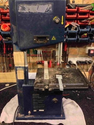

Thought I'd best post a photo of my modified bandsaw seeing as I described it in such detail in case anyone was interested.
It came with a (useless) battery powered laser guide that I've removed, and I junked the dodgy switch that it came with. I also added a small piece of extruded aluminium (DIN rail) as an extension of the blade guard on the left of the saw. I'm much happier with it now that I ever was before, I think it's a keeper now.
Re: Greg Robinson's Lap Steel

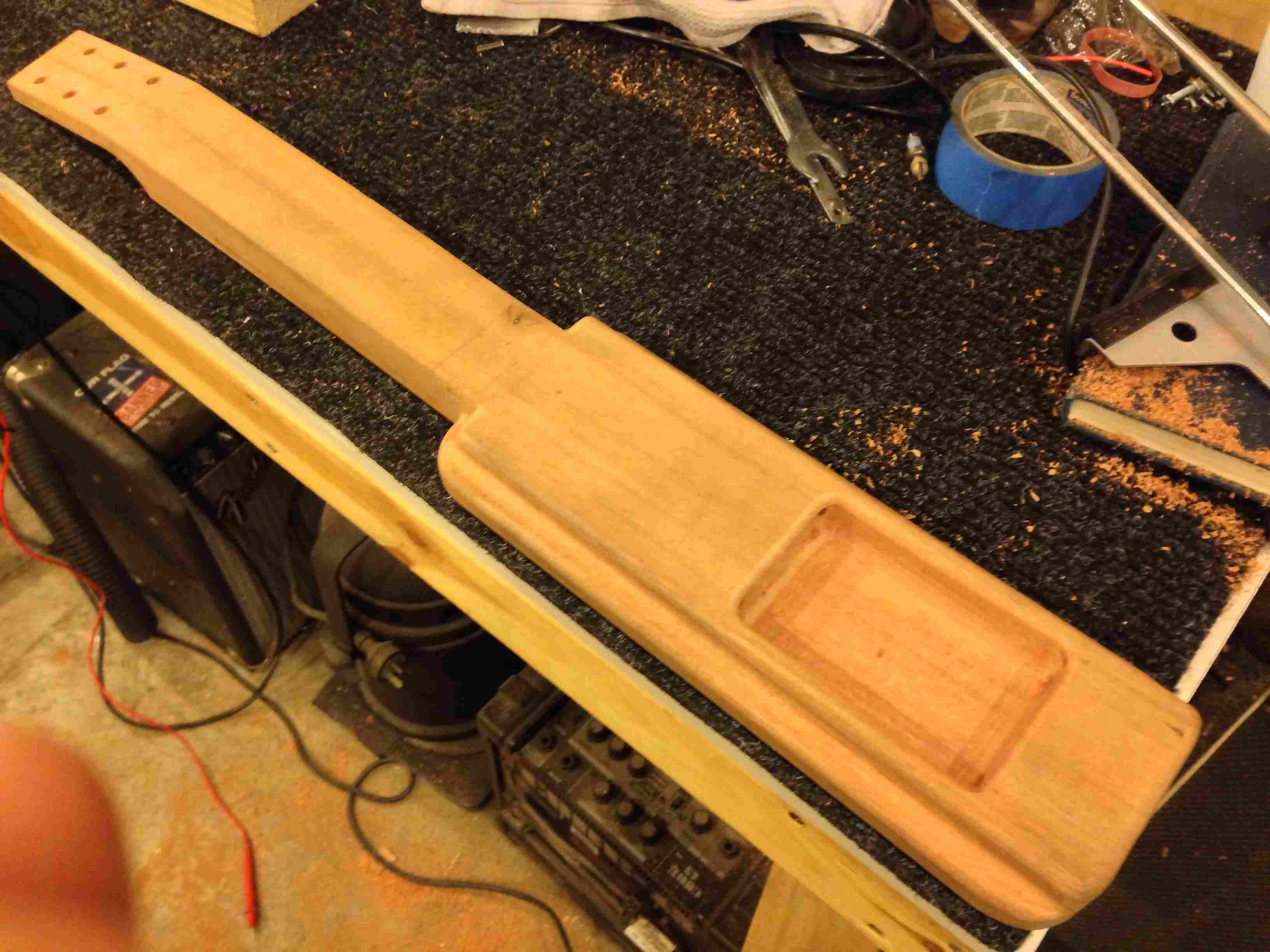

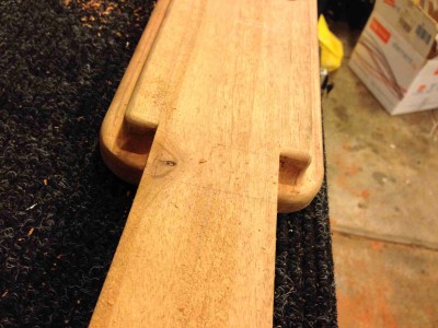

I've made a bit more progress with it, having attacked it with a router.

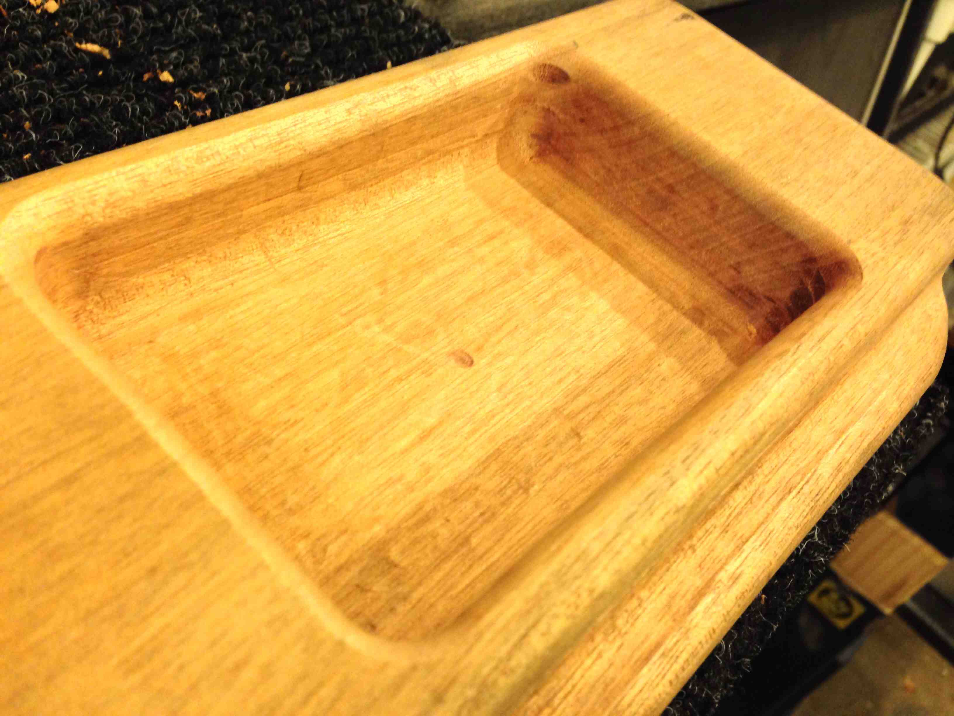

I've routed some steps into the wings, and given them a 1/4" roundover. The top of the roundover should meet at the 12th "fret" location. I had to work with chisels and files in the corners because of course a router bit couldn't manage that.
And here's the pickup rout, I'm trying something "new" (for me at least). It should be fun.

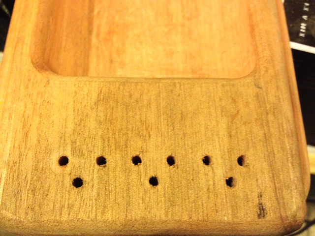

I've drilled the holes for the bridge mounting screws and the string-through holes on the drill press.
And just eye-balled the holes for the ferrules with a twist drill. They're not perfectly spaced, but this is for me, so I'm not fussed. Too much bother to jig up for this, although I should.

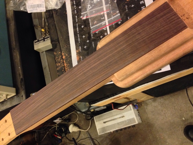

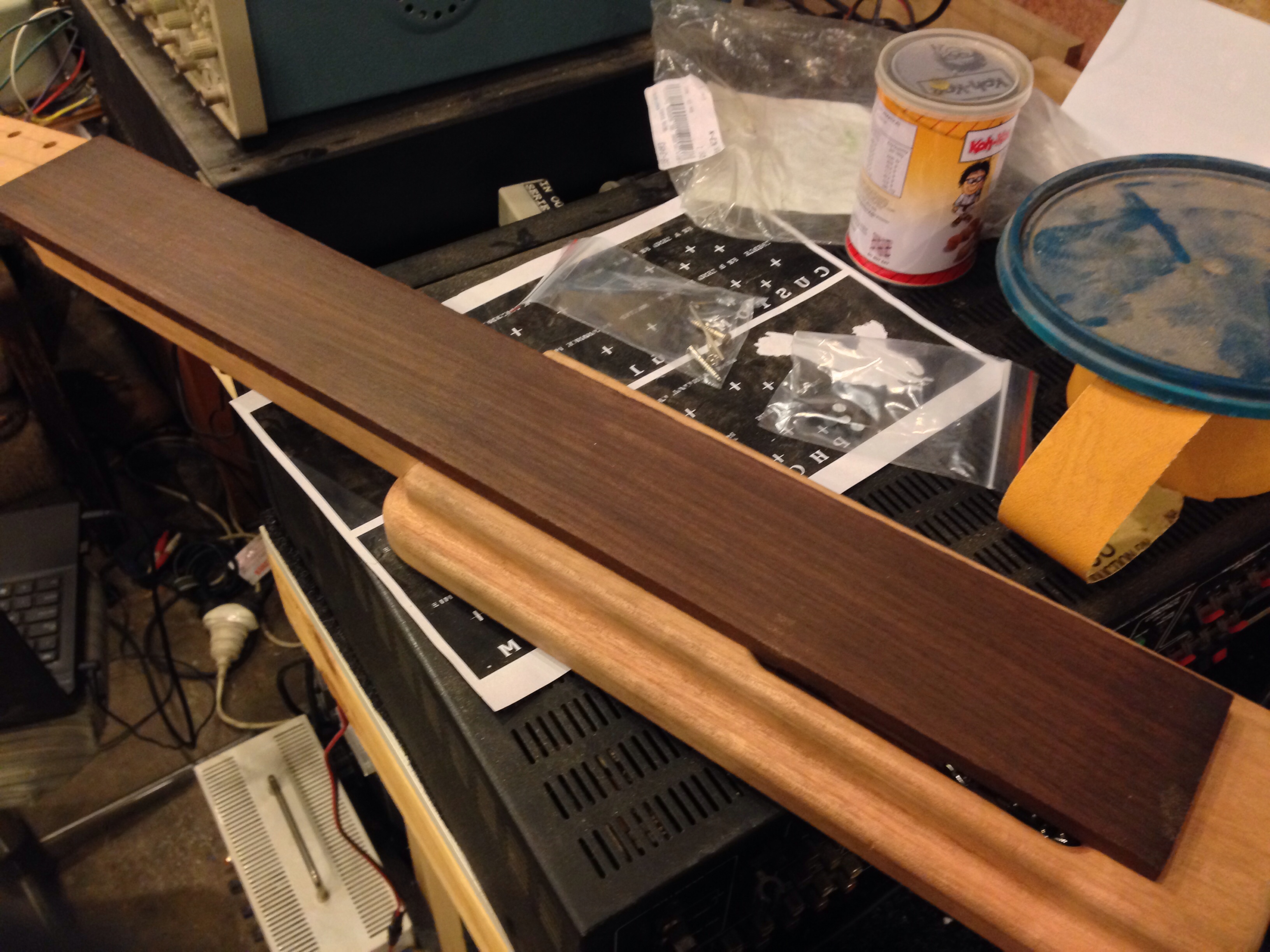

Here's the fretboard trimmed and after being run through my Luthiers friend.

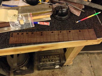

I forgot to take as many progress photos as I'd hoped today, but I've made some more progress. I hand scraped the fretboard level, then marked out, hand-sawed and beveled the fret slots with a triangular file. I managed to get a 22" scale out of it, I think I mentioned 21" earlier, but am glad I got a little longer. I then drilled out for and super-glued the black acrylic dots.
Then after level sanding the dots, I installed some mandolin/banjo sized fret wire with my arbor press. I used stainless steel as that's all I normally work with professionally, except for troglodytes who want to stick with nickel silver. I buy in bulk and have only done a couple of refrets on banjolins with this wire, so I figured I'd rather use that than one of my popular sizes. Plus, with the short scale it looks nicer to my eye than a medium or jumbo would have.
I then used my belt sander to sand flush the tangs and to start the side bevel (one advantage to fretting before gluing to a neck), and followed up with an angled file. Then on to detail files, to get a nice semi-hemispherical profile on the edges, and finally polishing up with an abrasive loaded rubber disk in my Dremel extension. This much care and detail were not strictly necessary because it won't be fretted, but I think it deserved it, and it was a good opportunity to demonstrate my fretwork techniques to my housemate.
After clamping in a reverse bow for a while to seat the tangs and get the board dead flat (again, not strictly necessary in this case), I glued it on with Titebond after giving the board and neck a quick pass with the hand scraper. I would normally use a non-waterbased glue (epoxy) on guitars to ensure that the neck comes out dead-flat, but the "neck" is thick enough in this case that it was not a concern, and anyway, I'm not going to be playing on the surface of the fretboard!
Next I'll be finish sanding and making the pickup. Once I've completed the finishing, I'll be able to oil up the fretboard which really makes it pop and makes the black dots stick out.
