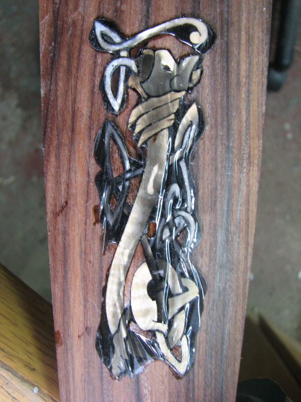

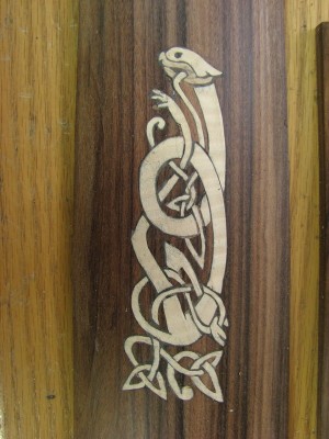

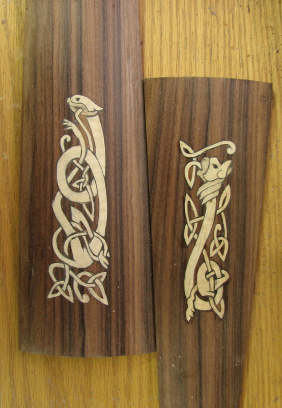

Tad-ah! Inlay for the viol fingerboard and tailpiece done and cleaned up! Now, I just need to do the borders...
Oh, and over the summer I had a real setback. My shop is not humidity controlled and there were some really high, overnight, humidity spikes which caused some glue compromises. Anyway, a few steps back which can be dealt with, but the time that it takes...well, it must be taken.
These inlays are a match for the relief carving on the scroll. Fingerboard and tailpiece are Santos Rosewood/Pau Ferro.
For some reason, the photos are always presented in reverse order to how I select them, so, last one first/first one last.

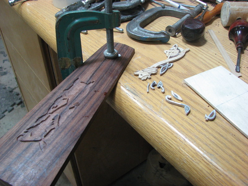

I did take a shortcut with cutting the inlay. I really couldn't face cutting all of those itty-bitty channels, so I cut them as part of the inlay, hollowed out a single large area, and glued it all in as a piece, except for the few outliers.

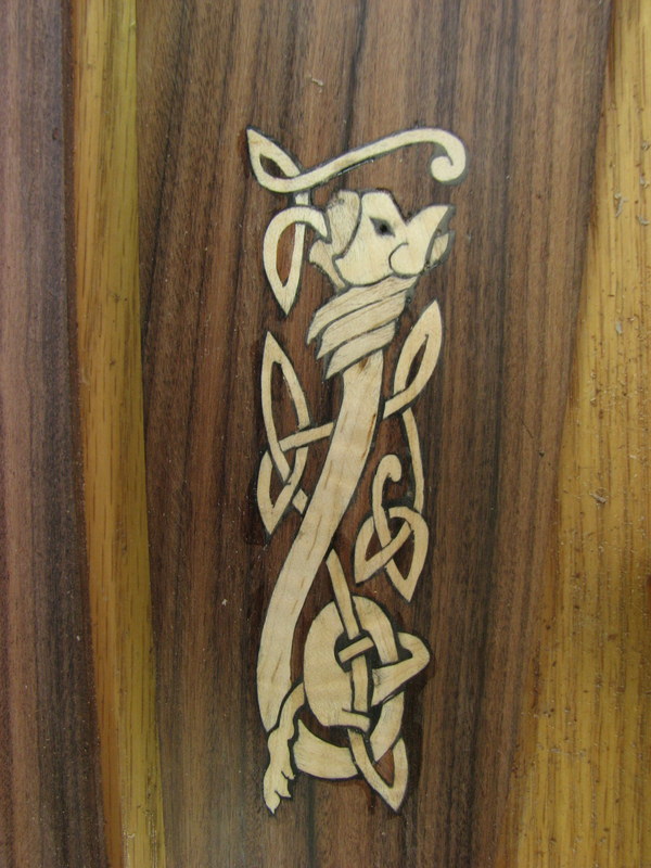

At long last I have the borders for the fingerboard and tailpiece for the viola da gamba done!
Time, now, for the next step, which is to get the inlay on the front and back repaired. I had some serious setbacks last summer due to exceptionally high humidity overnight for a few too many nights.
