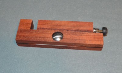

I am about ready to do a X brace joint, so when I saw Bob's post it got me thinking.
So I put this together.
Worked perfectly the first time on scrap.
I still need to make a small sled to hold the braces at an angle before I can do the real thing.

Nice knock-off Geoff!
The drawings in the patent are quite useful for making one's own "kerfmaker".
Some details of this Bridge City gimmick are patented indeed. If the claims would hold up at court is another story though.David King wrote: You can make as many of these as you would like as long as you don't use the trademarked name. These sorts of story gauges have existed for hundreds of years so I doubt anyone could patent them now-a-days.
