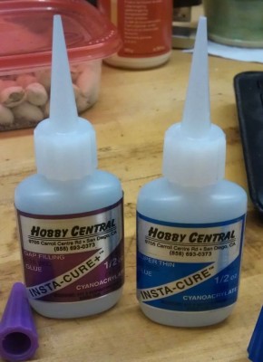

So I asked this exact same question years ago on this forum, and got a bunch of different answers.
I didn't follow any of the advise :-)
I have, however, developed a "discipline" (if you will) that keeps CA bottle tips clean, and the product usable for months - open - in my shop.
It is super easy and simple, and if you do this without fail then you can have clean bottles like you see below.
  • 1) When you are going to use CA - BEFORE YOU NEED IT - grab the bottle and un-cap it
    2) Clean any dried glue off the tip AND THE CAP so you are starting with a pristine bottle
    3) Use it and put it aside - DON"T CAP IT
    4) When you are done using it for the day - Clean the tip with a PAPER TOWEL of any-and-ALL glue that is on the outside of the tip
That's it.
This works because:
  • 1) You cap and un-cap the bottle a minimum of times, and only when it is clean
    2) You don't pile dried glue onto dried glue - accumulating a mess
    3) Paper towels wick-and-kick CA almost immediately so it does not get spread around
    4) The manufacturers of these glue bottles use a material that CA does not stick to so if there is a MINIMUM of cured glue, it is super easy to remove
As seen below, the bottle of thin (blue label) has been open and in my shop for MONTHS. So long that I have 3 bottles in the fridge because I've over-bought thinking that the open bottle "must be done", but it keeps going-and-going like the energizer bunny.
