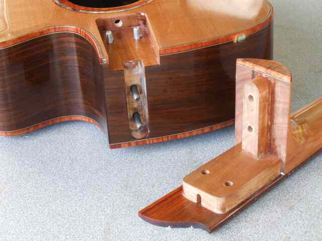

Double tenon bolt-on.Gordon Bellerose wrote:What do you all do...
Un-bolts so you can get the neck off in ~2 minutes if you want to. No more difficult to make than a tapered dovetail (once you know how!)Gordon Bellerose wrote:...and why?

I have to say that this is the first time I've ever seen that type of neck joint. I like the idea for sure.
Is it as simple as making the end block with a ninety degree extension along the top? Rout it out for the horizontal tenon, and vertical dovetail?
How does it affect tone?
How does it affect the bracing?
Can I find a plan somewhere?

The picture looks like the joint described well in Trevor Gore's "Build" book. He gives the full step process and drawings.
I've made neck joints like this and they are good, but have gone back to the Cumpiano joint (link below) and glue the fingerboard to the top. The Cumpiano joint takes less time to make and is lighter. Yes, it takes 20 minutes instead of 2 to take the neck off, but I don't have to take necks off very often once the guitar is done. The trick is to use just a small amount of hide glue needed under the fingerboard extension, mostly near the end, and just a little around the edges, a hot spatula will undo it easily. . Tone wise, I have not noticed any difference between various joint designs as long as they well made.
http://www.cumpiano.com/Home/Articles/S ... block.html

My heels look just like Trevor's except I use furniture barrel bolts rather than the threaded inserts shown in the pic for the heel. I embed a simple nut in the fret board extension tenon before gluing on the fret board

The neck joint in the pic above does not use threaded inserts of the type typically used in guitars (and furniture). The heel bolts thread into a 3/8" x 3/8" square rod which runs down the length of the heel (perpendicular to the fretboard) and the fretboard extension bolts screw into T-nuts under the fretboard.Steve Rolig wrote:My heels look just like Trevor's except I use furniture barrel bolts rather than the threaded inserts shown in the pic for the heel.
Having the neck easily removable is only one part of the deal in this neck design. Having the solid wood under the fretboard extension minimises the hinge effect at the body join that can be seen on many guitar fretboards and having a fully free standing neck structure allows the board to be fretted before it is glued on. With practice, the fretting and subsequent glue-up can be accomplished with such precision that in most cases fret dressing can be eliminated, which more than saves the extra time taken to make the joint, which I would argue is easier to make than a well fitting, properly angled tapered dovetail.
When building, it is best to think in terms of a comprehensive build system rather than mixing and matching styles, techniques and methods. Not only does this make for efficient building (important to professionals) but it also ensures everything goes together in order and as it should with no hard-to-fix surprises (like neck angles not matching top curvatures) down the track, which is important for professionals and non-professions alike.

Sorry to have misinterpreted you pic Trevor.
