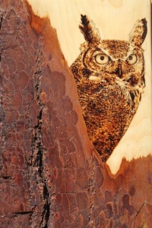

Re: Woodburning on the soundboard - adverse effects??
Here's a picture of what I might want to burn onto the top. The deepest burns are about 0.6mm deep.
(Tried posting the picture once already... see if this works)

Wow! Nice image.

Dang, Zach, that's some skill! I always thought it would look cool to do a shading effect with a hot sand method (forget what that pyrography technique is called) near the binding and rosette.
Rather than adding a veneer I would be inclined to leave the soundboard slightly thicker to compensate for the depth of the burned areas. I have seen some dulcimers with wood burned designs in the soundboards, but the burning is pretty shallow, much less than 1/2 a millimeter.
