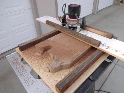

If you have a router you can easily make a sled that rides over the workpiece to plane it. It should work for thin stock too if you hold it firmly with double sided tape on a flat surface.
