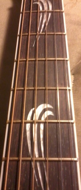

hello again, one more question before i start my refret. I've ordered evo fret wire ,as the subject states. and read a few things here and there, and am just curious how much of a pain it's going to be to install. it's coming with a 10" radius, and my neck is 16". i have heard a few times that it is really springy and can lift out of the fret really easy, and as it's radiused quite a bit more than my board just thought i would give some specifics and see what you all thought. i'm going to be gluing a few for sure because of some inlay and don't really mind gluing them ( fret wire lasts me a while usually ) but i saw somewhere that someone was having such a hard time he ended up gluing and clamping. my fret slots are still nice and tight, can tell this will be the first refret. thank you ahead of time for any help.

sorry everyone thought i had already responded to this thread. yeah your right it's a lot easier to work than the nickel. filing cutting, just softer. almost don't want to believe it can last longer. ;) i ended up doing combo press and hammer, "tap" and ca glue. wanted to get better glue but it's holding up nice for now. thanks for all the advice everyone. i'm learning.
