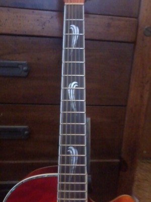

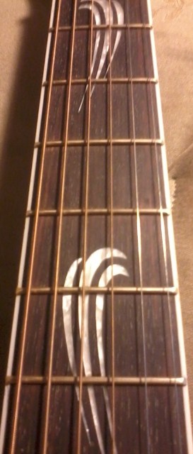

hello everyone. well getting ready to do a much needed refret on an acoustic. but a little concerned about the inlay that goes under the frets. been searching through forums for a few days now without any luck. saw one this morning that said something about using epoxy on said frets in this kind of situation. i can't imagine that happening at the factory but if that's the case i'm prob out of luck pulling those frets. i also read somewhere about heat hurting inlays. i don't think they were talking about mop, but i never worked with it. would heating the frets that are right on top of it do any damage. the frets are glued in, i pulled fret # 1 to check. and lastly how about hammering the frets back in? is mop strong enough or should i opt to press at least those frets in? well thanks ahead of time for any help i can get.
the inlay actually goes all the way under the fret

The inlays should have been cut a little short of the fret so that they don't hinder insertion or extraction. So you should have no problem. A little heat to pull the frets should also cause no problems.

thanks for the quick response. had a closer look and i still think it is cut right up to the slot. i guess the only way to be sure is to pull one. i'll go ahead and do that.

well pulled 2nd fret. the inlay is all the way up to the slot. thick inlay too, runs the depth of it. one of the pieces moved a little to so have to reset. after looking at the slot and pondering my options i see pretty clearly that i'm gonna have to press them. even if it doesn't hurt the mop, there's too great a chance of breaking it a little loose causing it to vibrate. didn't want to have to press it as i have to build a caul, already have a hammer.ha. well, got enough time to prep the neck and make new nut before fret wire gets here, got plenty to do though. thanks for giving me a little more confidence

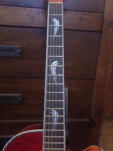

ok sorry it's been a while been busy with a 2nd job i started the other day. well refret is done, did a level and re crown/polish, and made a new nut. gotta get some strings and finish with setup but turned out pretty dang good. thanks again all for your help and tips. and sorry again Mark Swanson, really quite embarrassing even spelling someones name wrong, getting it all wrong. :oops: SHEESH!! thanks for all the help.
