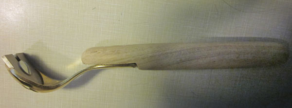

I found this http://www.woodcraft.com/product/200486 ... plane.aspx very useful carving a mandolin top and bottom. The handle on it is useless. I cut it off about halfway up, drilled it, and attached to to a much longer handle that I turned. That made it a wonderful tool. I bought a double-curved bottom finger plane (with a palm extension) from Lee Valley tools http://www.leevalley.com/US/Wood/page.a ... at=1,41182 for the finer work. To finish it off, I used a scraper. The Carruth scraper from StewMac https://www.stewmac.com/shop/Tools/Scra ... xsr=264478 is well worth the expense. There are other ways to do it, but I found these tools to be sufficient and even pleasurable to use. And each is well worth its cost.

Bob, nice modification of that pullshave. I have one and love it, except for the handle. In fact, I wrote a review of for American Luthiery several years ago, and the handle was my one gripe.
Re: Carving tools?
I'll second Andrew's praise of your spoon handle, Bob. I bought one years ago with an idea to modify the handle. That looks quick and easy.
