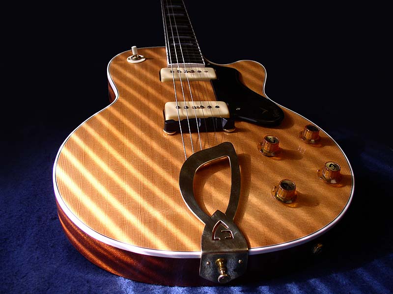

The hollow body you're talking about was called the M-75 Aristocrat, not Bluesbird. This is the '59 I restored and sold a couple years ago. There were two 3/4"w parallel braces. Top sides contoured to mate with the moulded spruce ply top, and I never took measurements but I'd say they were 1"- 1 1/2" tall. It was a hollow body, not chambered. The bridge mounting bolts went in to about the center line of the braces, so did the pickup mounting screws, so that tells you what the spacing between them was.
