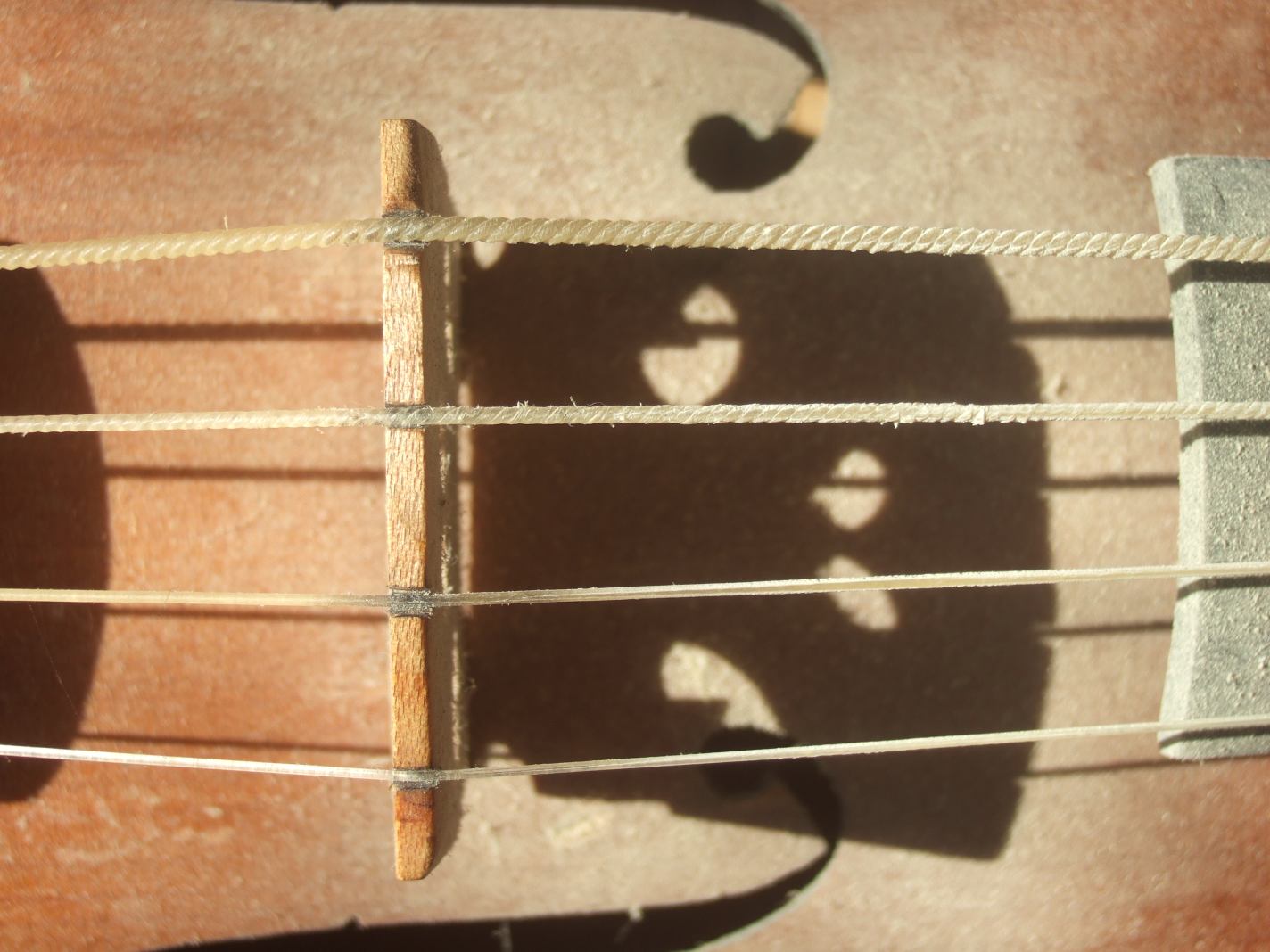

My fiddle is set up with all gut strings, from Ephraim Segerman at N.R.Instruments in England. The 2 bass strings are very thick and knobbly twisted gut; the two trebles are smooth plain gut.
Anyway I find that the highest string is a bit fragile and expensive to replace (even with the fiddle tuned down one note all the time) so it usually has a nylon fishing line on the highest position.
Yes I roughened the bowing area with fine sandpaper to help the rosin stick.
The sound is a bit brighter and harsher than the gut but not too bad to be really noticeable in ordinary everyday use.

Hi Clay, on the fiddle, the 1st string only is plain nylon fishing line, about 0.65mm diameter (I can't find the reel to tell you the actual specs). To replace a low-twist gut 1st, the label says 22.5 (is this 0.0225"?).
The 2nd is 28.5 medium twist gut
The 3rd is 40 medium catline 3 strand
The 4th is 57 medium catline 3 strand

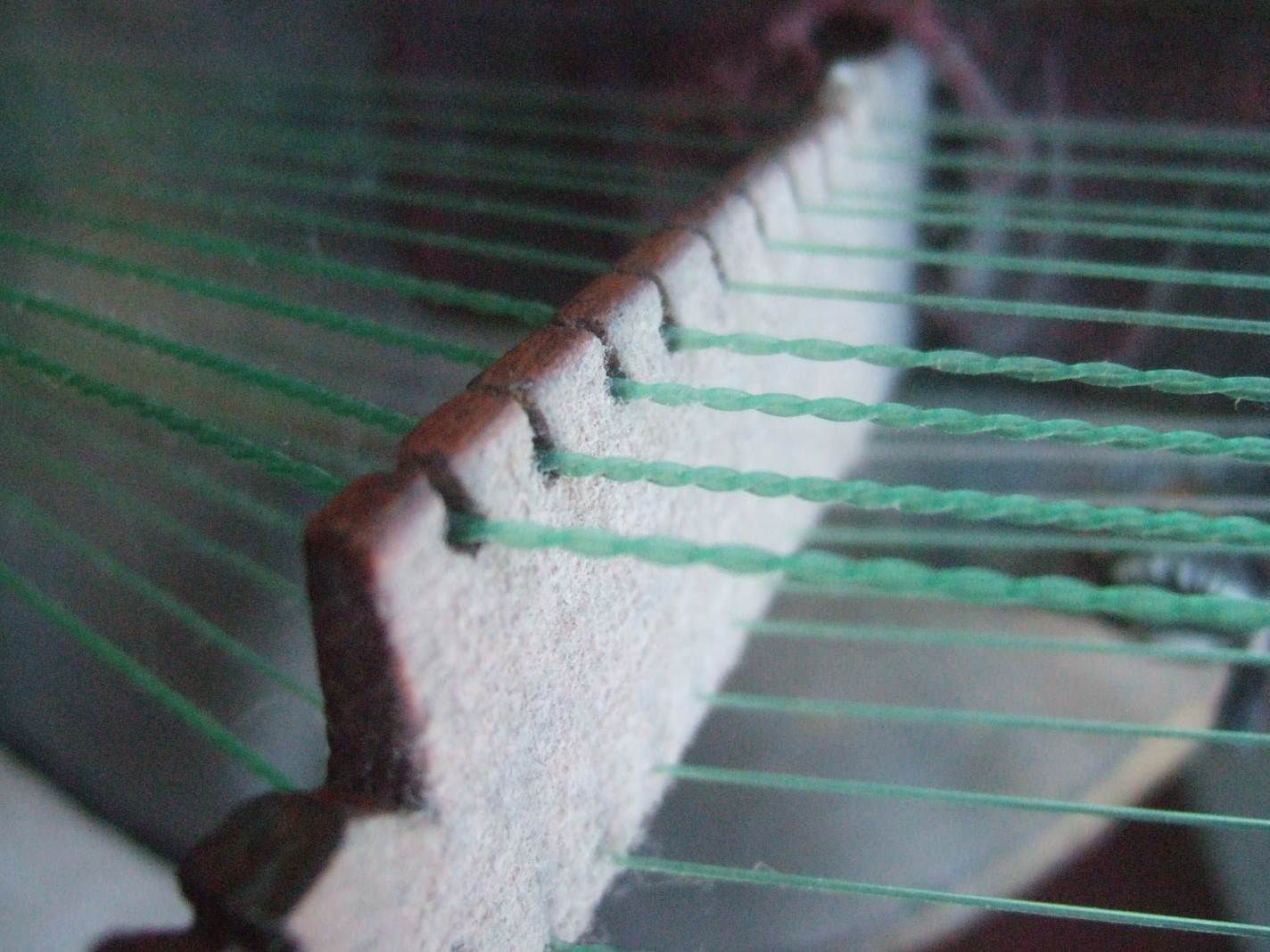

Nylon catlines - I have never tried these on the fiddle, I note Ephraim's advert for them on the link given above, and am curious. On my kora, the strings as I got it are green nylon, and the basses are 2 strand catlines, very loose twist. They don't stick to themselves, but they dont unravel because age has "set" them in their twist. Photo attached.
Kora with twisted green nylon bass strings, monofilament green nylon midrange and the same clear nylon trebles as on my fiddle
Also I am now also curious that Ephraim mentions on his website "high-twist monofilament" nylon strings, and I am wondering if twisting the monofilament nylon will make it more flexible and less harsh sounding? Perhaps I will try on the fiddle, I guess I just undo the string from the peg, turn the loose end 20 or 30 times and wind it back up to pitch?
