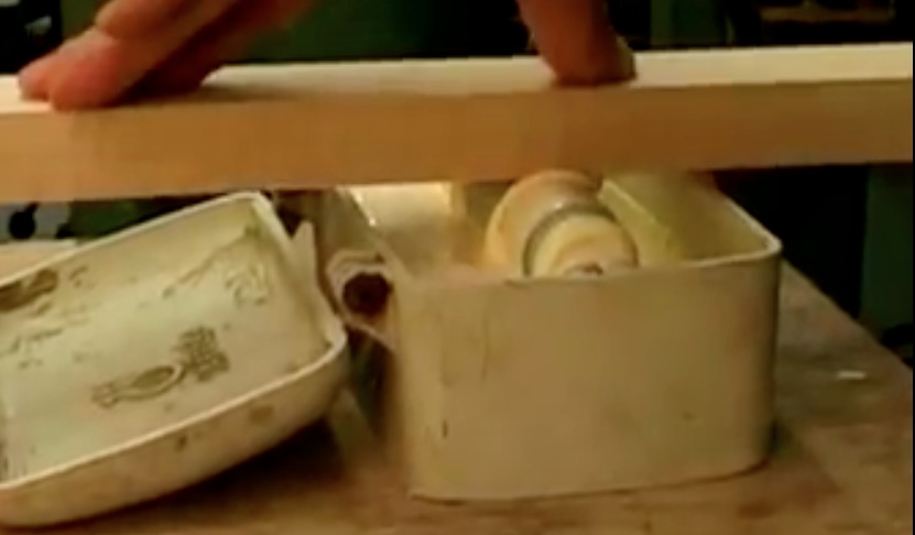

If anybody checked out that youtube viddy of the the Hofner factory, maybe you saw this nice little item. Anyone know where to find one of these?

I saw the video, and thought it was a great idea. However, I quickly realized that this is probably something you have to use every day. Great for factory setting, but in a small shop like mine, where I might not need this for weeks, I can only imagine opening it up and seeing a mass of hardened glue. The short answer is that I have no idea where you would get one. Maybe they made them themselves. I have seen something similar for wetting paper packing tape in shipping departments (that was a while ago before everything became self stick).

Roller applicators like the one (formerly) pictured that attach to the glue bottle can be found at any woodworking supplier. I agree that unless you're in a fast-paced production settling, a bench mounted version would waste a lot of glue, and time, seeing as how it would need a major cleaning before or after every use, unless it is used a lot.

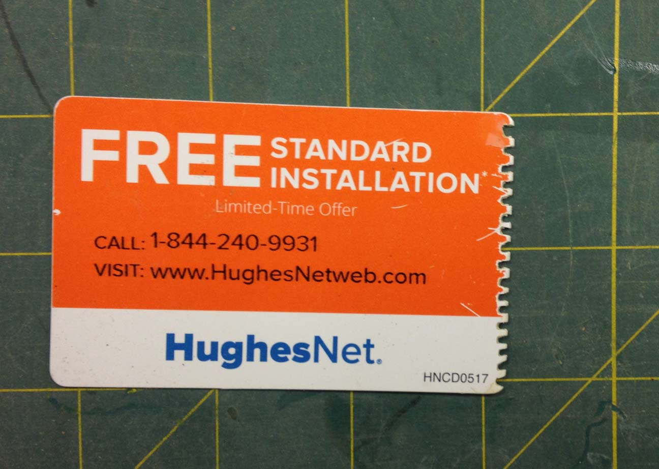

Just came across this thread and thought I'd add my spreader to it. I used to use a drywall mud spreader for large surfaces that I couldn't apply glue fast or evenly enough to with my finger (fret boards, electric tops). Then I misplaced it and had to make my own - a credit card notched with the band saw. Have used it for years and only took a minute to make.

As an aside, in reference to the original glue spreader pictured, I have seen similar spreaders used in busy diners to butter toast. It just sits at a corner of the grill or near enough so the butter stays melted, and they use it all day for buttering the toast very quickly.

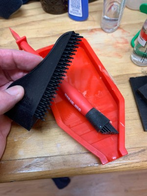

i got this silicone glue brush set for X-mass. it is pretty awesome.
They are not as easy to clean as you might imagine, but they spread glue very easily and uniformly.
And the clean-up spatula on the other end of each brush is PERFECT for hide glue once gelled. It gets flat on the surface and does not dig in. And the glue does not stick to it, so you can easily wipe off the "booger" and immediately continue cleaning up. I've done the same thing with spruce, but the glue sticks so well to the spruce I would have to use lots of sticks or slice a new feathered edge every "swipe" or so.
I used to use an old poster paint spreader with a notched edge. It worked well, but not as good as these.

Chuck,
Have you tried just letting the glue harden and then pull the dried glue off in one piece? Usually comes off easy that way.

Randy, I'm still figuring it out. First time i used it was with Titebond and I started cleaning it before dry all the way, and it left some glue way down deep in the bristles. Still cam out, but i had to dig.
Next time was with fish glue, and i left it longer and had better success when dry. But fish glue dissolves so easy in hot water all i need to do is run it under the hot tap and it is totally clean

Device shown in first post looks like stamp or tape moistener from long ago. Office supply house item. I saw one in 1971-2.
