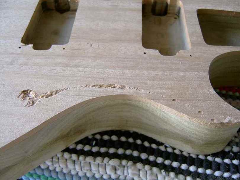

A bad one I can remember now was a "flying router". The router got out of control while routing the pickup cavity and damaged the top. After a lot of sanding, the remaining hole was filled with thickened PU finish. Luckily, that hole ended being under the LP-style pickguard.
These things must be held REALLY tight while working.

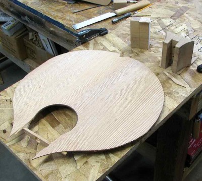

I'm building my first acoustic instrument - an Irish bouzouki. The top is Douglas fir. I knew it was brittle, and tried to avoid dropping it, but it just seemed to fly out of my hands onto the concrete floor about 2 hours ago. That's the headblock, tailblock, and a little extra piece at the top of the pic.
The reason it happened is because I have parts, tools, scraps of wood, and all kinds of crap piled on my bench, so there's no place to put anything down. I need to learn to straighten things up more often.
- Posts: 275
Re: Mistakes made while building early guitars
My tablesaw has been my bench for a long tome, since everything else seems to pile on the bench. Needless to say, I can't tell you how many times I've set stuff down on my "bench" only to have it scratched up by the tablesaw blade I forgot to retract...Peter Wilcox wrote:I'm building my first acoustic instrument - an Irish bouzouki. The top is Douglas fir. I knew it was brittle, and tried to avoid dropping it, but it just seemed to fly out of my hands onto the concrete floor about 2 hours ago. That's the headblock, tailblock, and a little extra piece at the top of the pic.
