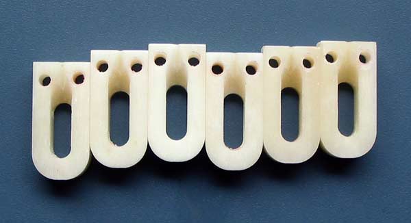

Re: bone nut question
Threading bone works beautifully, I recently made a set of strat saddles an had no problem drilling and tapping holes that were only .01" from the edges. Good bone machines really nicely but you will run across some porous stuff and some internal fractures occasionally.
If you are going to tap the stuff regularly it pays to use a spiral point or spiral fluted tap that's HSS or even TIN coated. I used a jewelers wax lube as well.

I stand corrected! That is amazing work , David!
- Posts: 232
Nice work! I'm very impressed.
