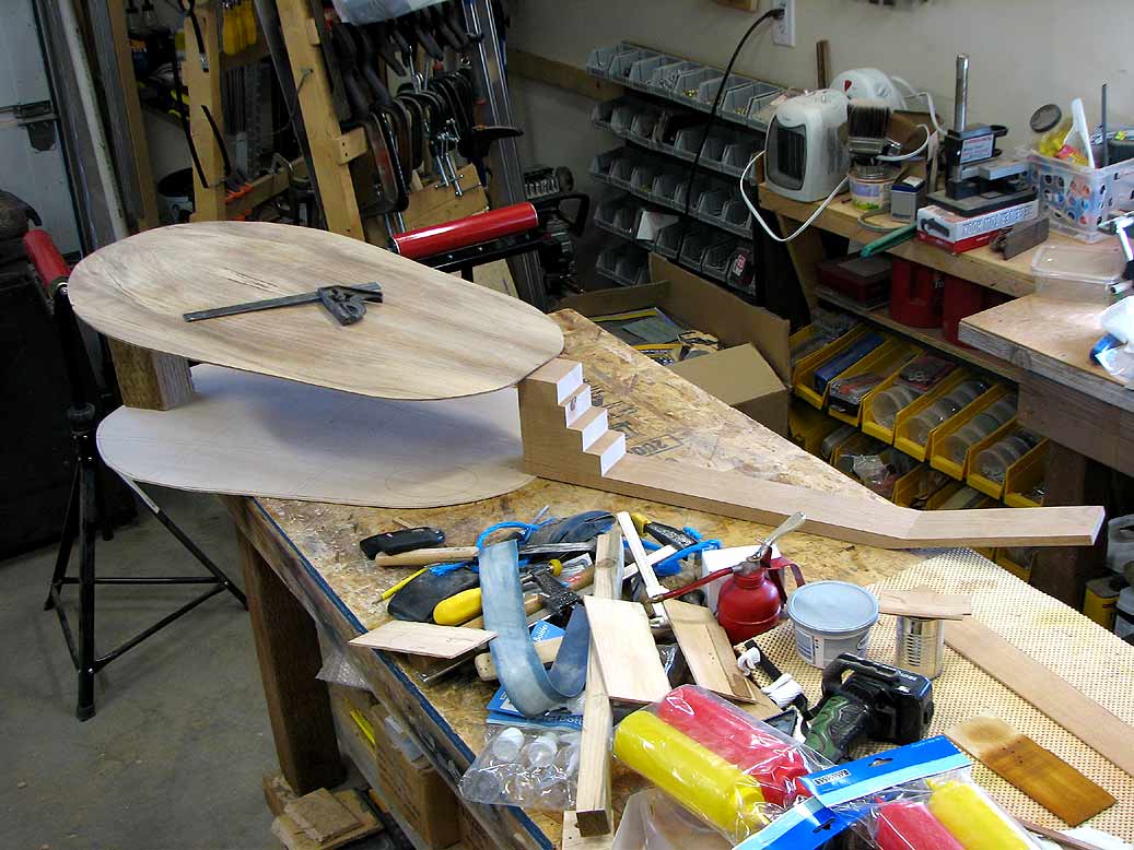

Postby Peter Wilcox » Mon May 07, 2012 9:24 pm
A mock up to see the size of it - it's more ginormous than I thought (that's a 12" square.) It's 58" long. I was hoping to be able to play it slung on my shoulders, but that may not be possible.
Posts: 156
Re: Acoustic bass, elliptical shape
Postby Peter Wilcox » Mon May 07, 2012 10:04 pm
If the tailblock and heelblock make a right angle with the top, then the back has to be slightly longer than the top, which is 30". By using either 5/{sin[arctan (5/30)]} or the Pythagorean theorum, it comes out to 30.414". I suppose the extra length should be stretched out over the whole back, but I just added it to the straight parts in the middle, keeping the upper and lower curves the same.
I don't know how to calculate the widths of the sides at different points, especially near where they meet the end blocks, so when the time comes I'll temporarily attach the top and back together with the head and heel blocks, and draw out a template.
Posts: 156

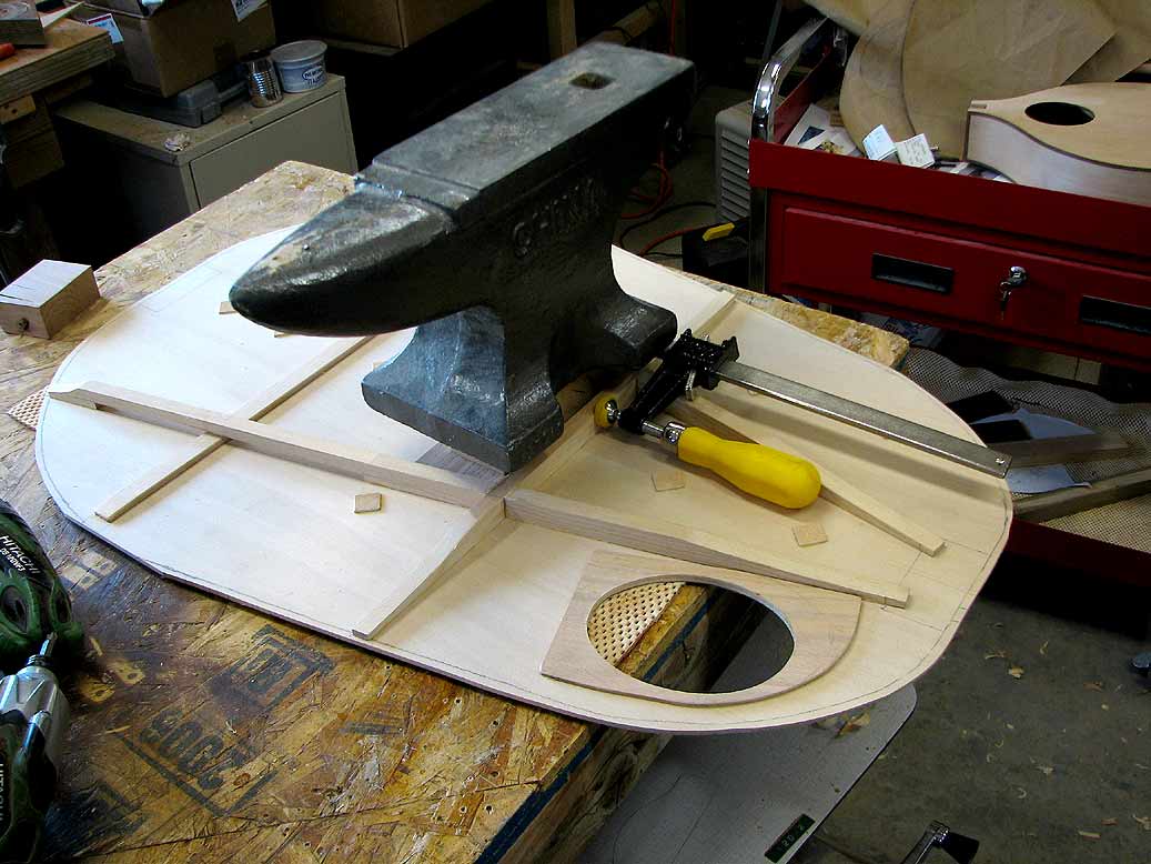

Postby Peter Wilcox » Fri May 18, 2012 8:39 pm
Cut the sound hole, added a plywood brace around it, glued on the top braces and the bridge plate. The top has a radius of 30', the back 15'.
Posts: 156
