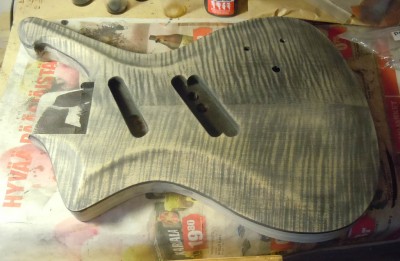

Postby Tristan Williams » Sun May 13, 2012 6:36 am

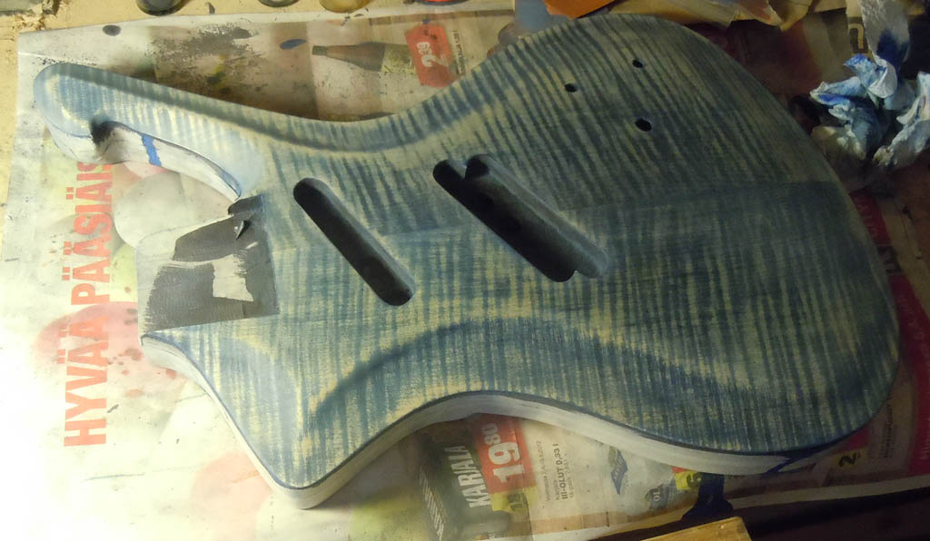

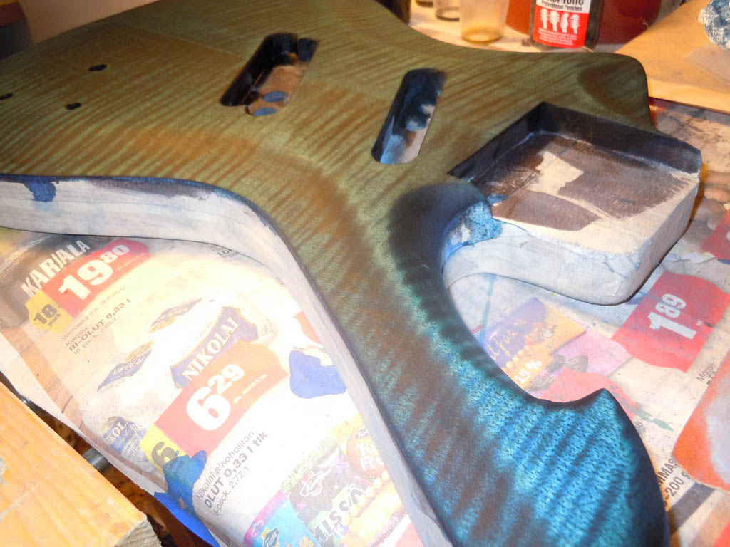

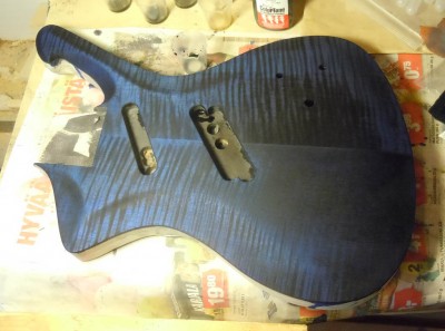

Lots of sanding leaves a zebra effect:
Next I use a very dark blue as the main colour:
I'll sand that back and use a much lighter blue as a highlight. I may mix in a little yellow to give it more of a cyan/turquoise look.

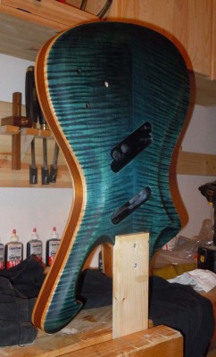

A bunch more sanding leaves dark blue in the "deeper" parts:
Then I made a rather dilute blue with a drop of green in it and applied that over the top:
The result is a little darker than I was shooting for but I dig! When the light strikes it at an angle it is like it glows from the inside:
I'm calling the top stain done. I'm not sure what to do with the back, I may either stain it as black as I can go, or leave it natural.

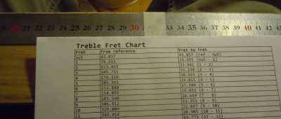

Postby Tristan Williams » Mon May 14, 2012 4:26 pm

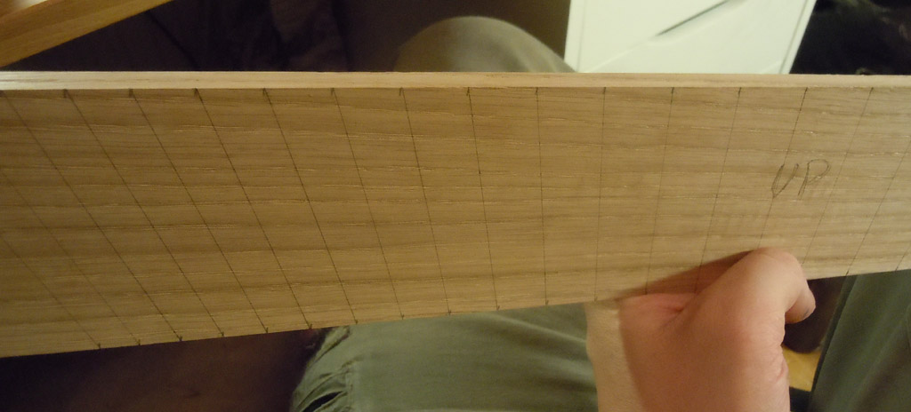

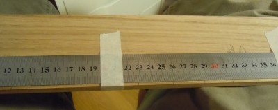

I printed off the fret charts from my software and got cracking on the fretboard. First I marked a reference line - the software references both scales from the one mark to ensure the angles stay accurate. The charts it gives take into account the fact that the fretboard blank is an untapered rectangle.
Deep breath and off we go! Mark the bass side first:
Then the treble side:
Then join the dots:

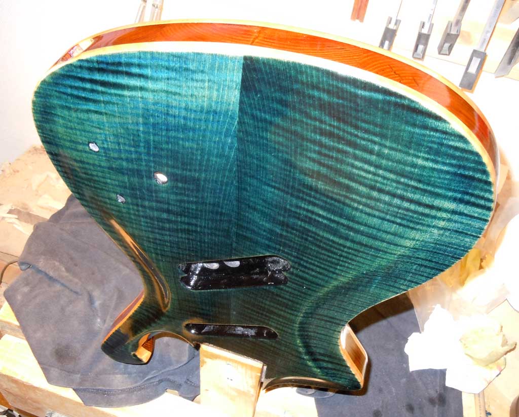

I thought I'd add some more oil before setting up to cut the fret slots, and its building so nicely that I thought I'd share. Tru-Oil is fantastic stuff.
I'm loving that colour the more I look at it:
Detail of the cutaway - in this picture the colour of the pine is dead on what it looks like in person:
As you can tell, my shop is somewhat lacking in terms of dust control. I have to very thoroughly clean the guitar between each coat to eliminate all the specks that settle on it while it is drying.

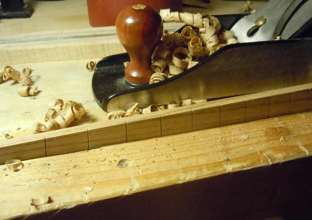

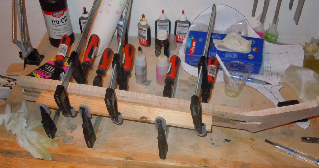

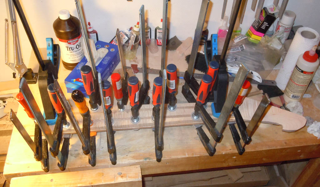

Postby Tristan Williams » Tue May 15, 2012 7:32 pm
Tapering the fretboard is fast, quiet, and easy with a plane:
Time to give my clamps something to do:
It doesn't seem to matter how many I buy, I could always do with more clamps...

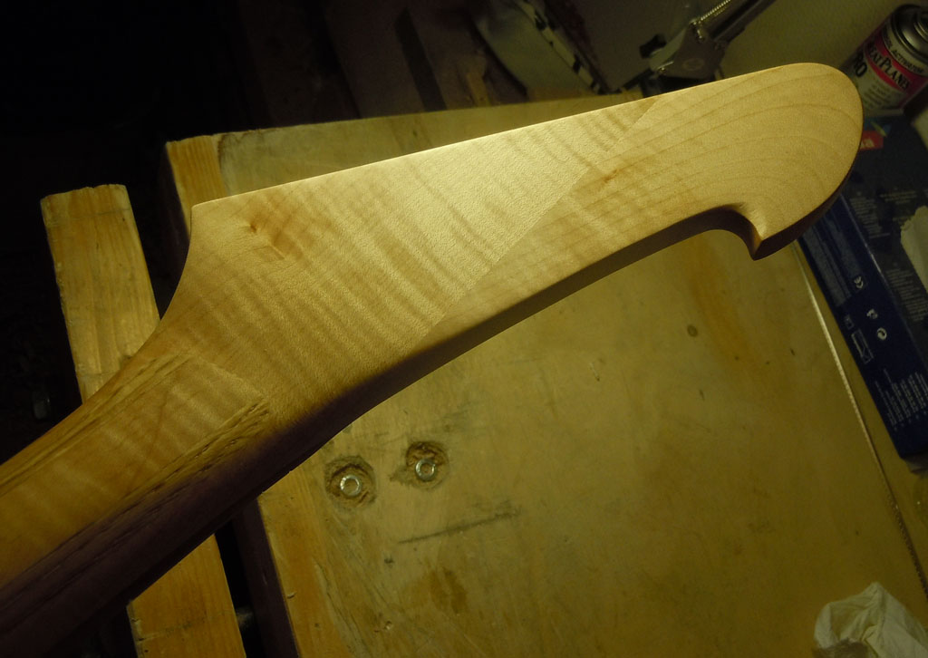

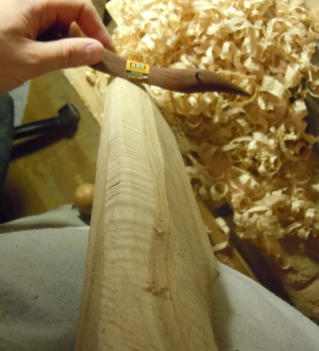

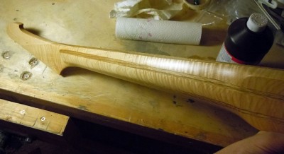

Time for the fun bit! I hogged away a rough profile with rasps at the first and twelfth frets:
I joined them with a spokeshave:
And cleaned up with rasps, files, sandpaper, etc:

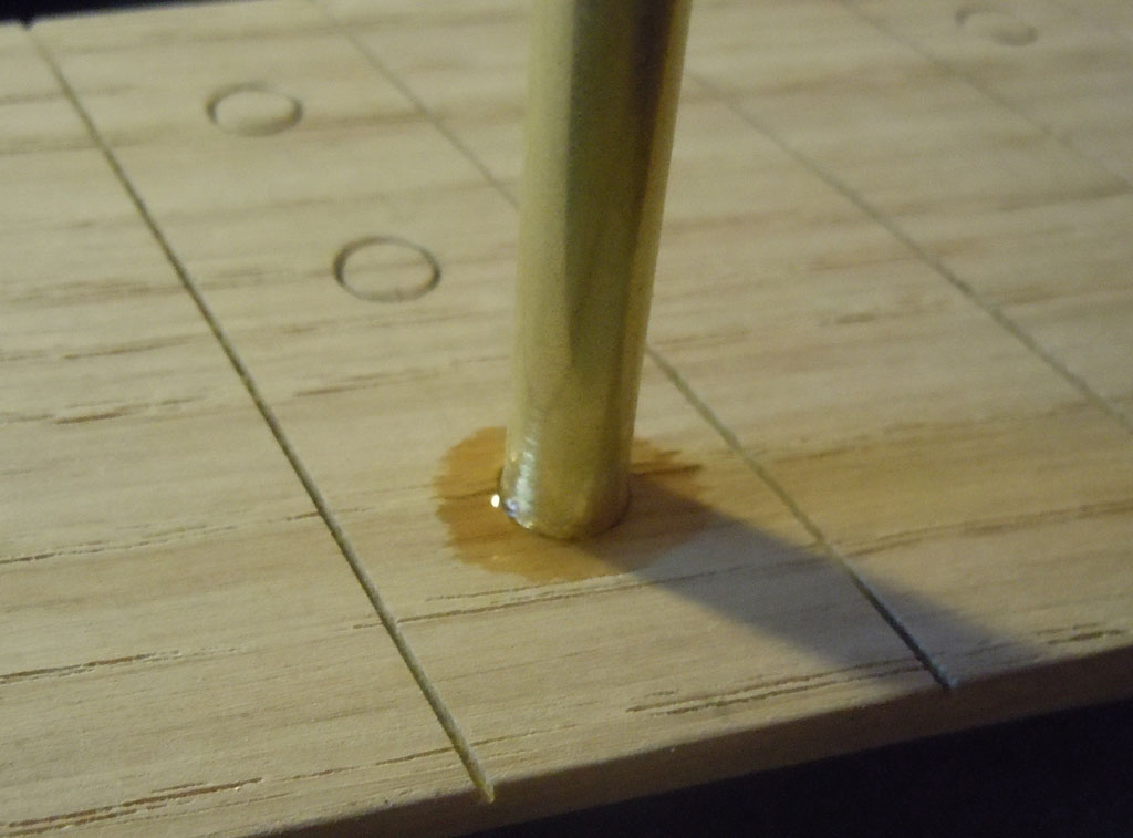

Postby Tristan Williams » Thu May 17, 2012 10:41 am

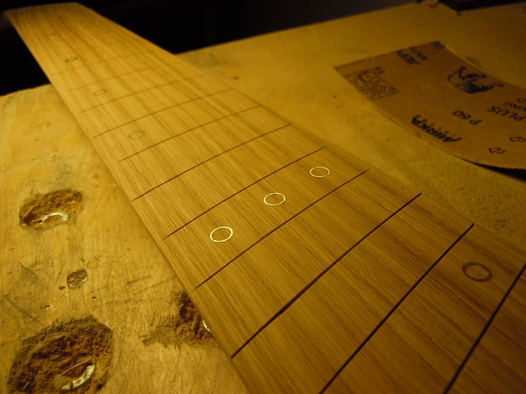

For fret markers I thought I'd inlay brass rings. I cut a short length of tube and chucked it in my mill to use as a drill:
I glued the tube in with medium CA:
I wiped off the excess, sprayed it with kicker, and let it dry. Then I cut it off close to the board with a fine metal cutting blade in my coping saw and filed it flush with the board.
After radiusing the board with a 14" block it looks like this:

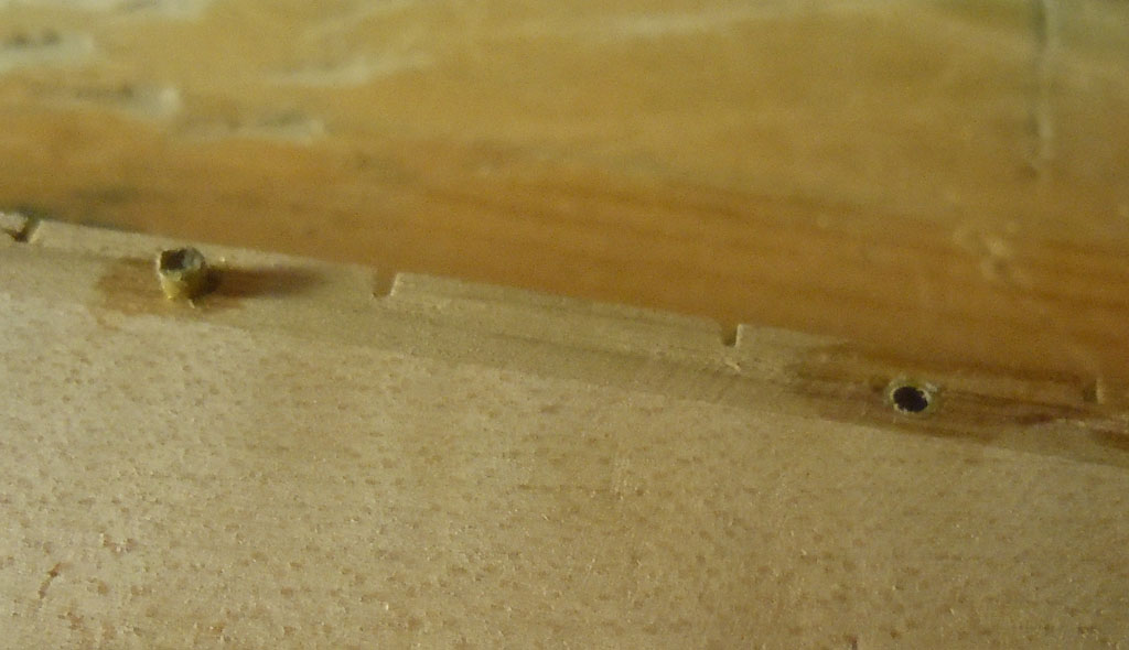

Postby Tristan Williams » Thu May 17, 2012 6:24 pm

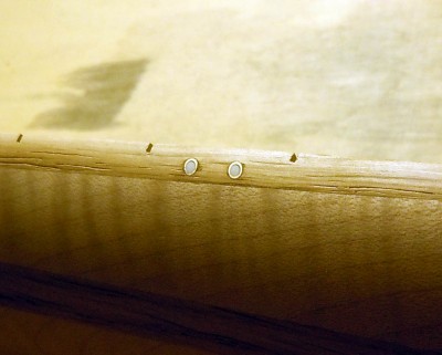

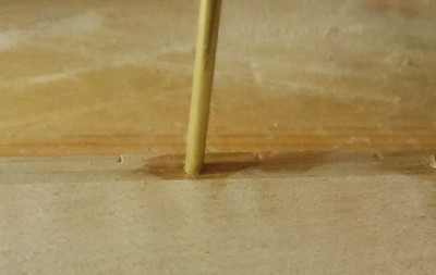

Onto the side dots! I drilled a 2mm hole first, then glued in some more brass tube:
After cutting it off, I filed it back flush with the fretboard and drilled it out to 1.6mm:
Into that hole I glued ordinary white plastic side dot rod. The result is easy to see from any angle and looks really cool when light catches it just right. Sadly its really hard to take a good picture of it, so here's a not very good picture of it:

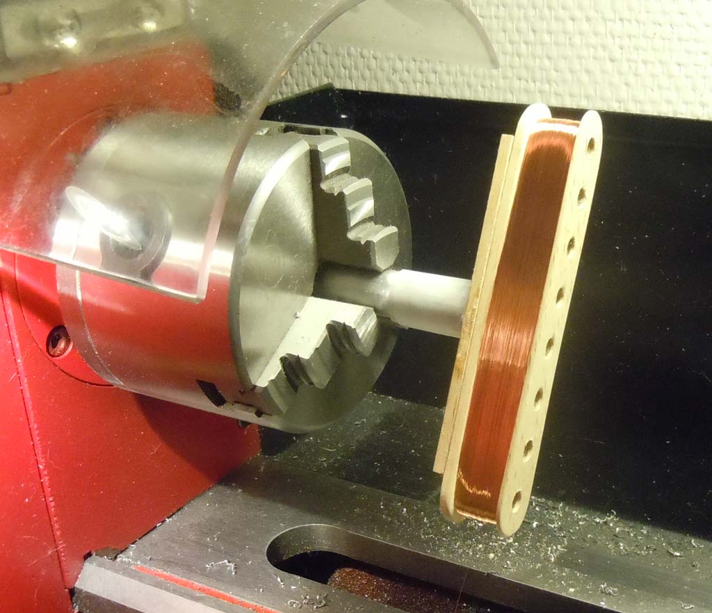

I don't think I'm going to make it by midnight, but I'm giving it a good shot. Frets are installed, levelled, crowned, and polished, pickup bobbins have been made and I'm in the process of winding them now. I've made all of the polepiece slugs. I'd love to stop for pictures but I'm off and racing!

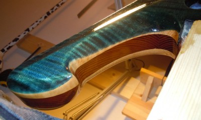

Postby Tristan Williams » Sun May 20, 2012 5:31 pm

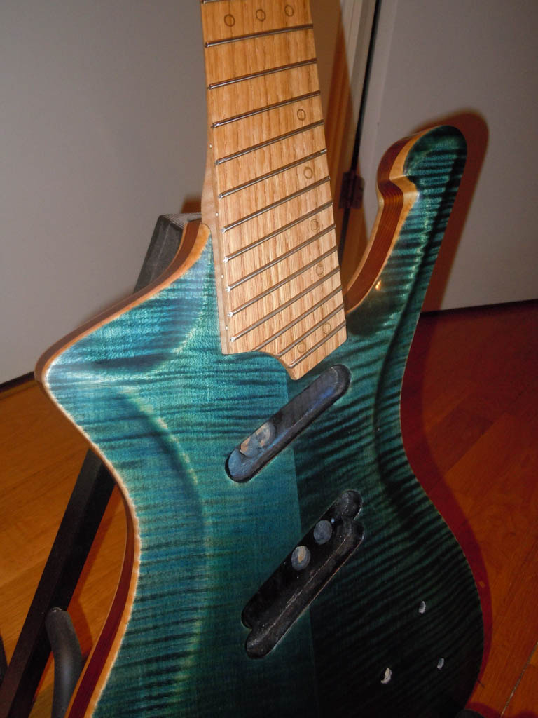

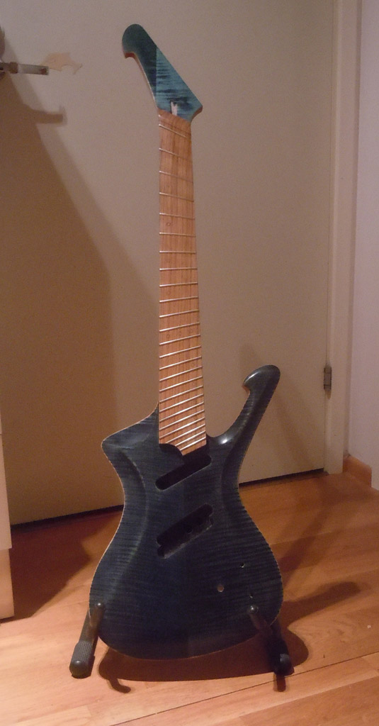

Time to admit defeat, I think. I think theres only about 8-16 hours worth of work left in it, so I came close, but no dice this time. I got a couple of the bobbins wound, but its past midnight here and I have to work in the morning. I'm extremely happy with the result so far, however, and I'm glad I gave it a shot!
A few pictures of how it looks. Without flash it looks like the ocean:
With flash or when it catches the light it livens up a lot. I'm super happy with the colour.
A closeup showing the gorgeous pine - big success, I'll definitely be using it again. Perhaps a Telecaster? Hmm..
