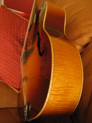

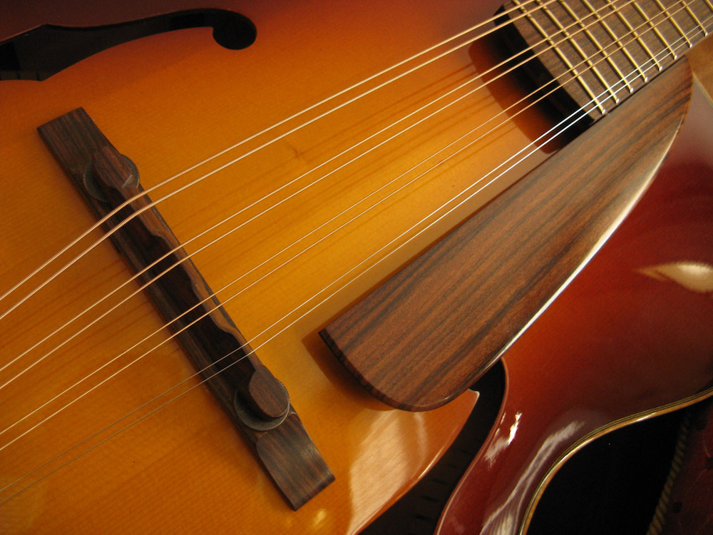

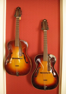

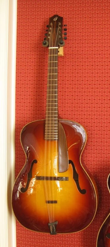

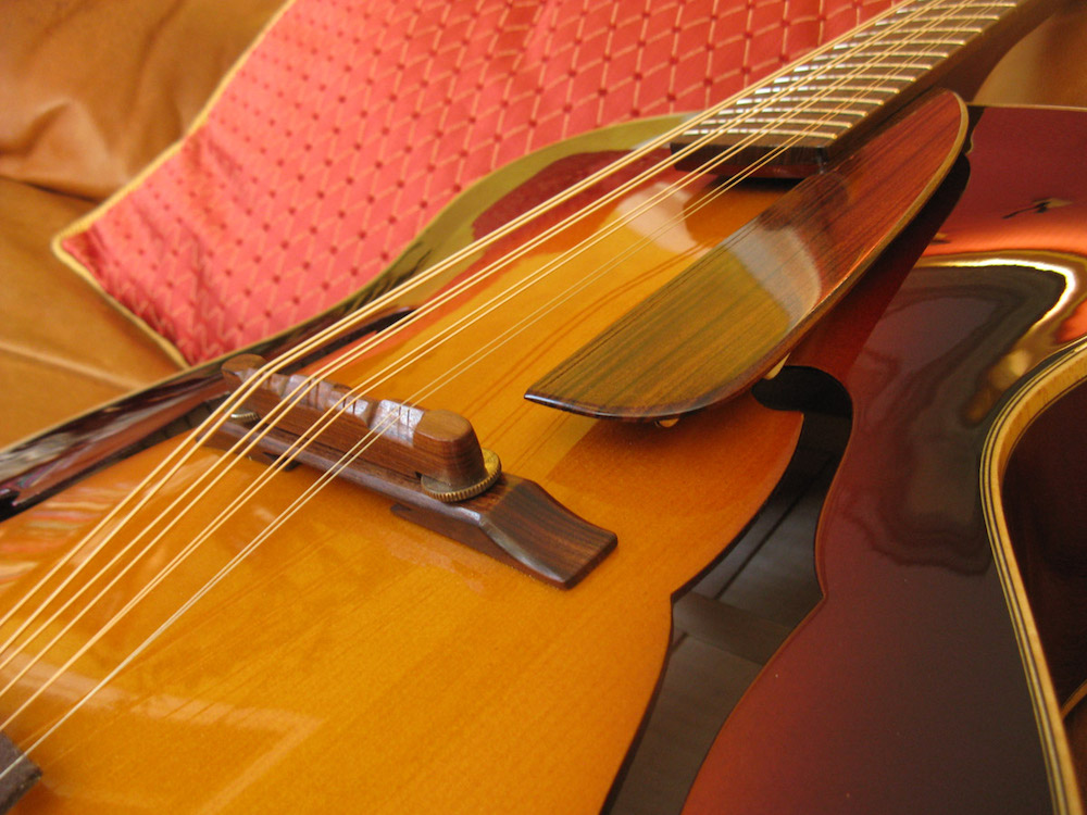

There's no real functional difference between the latest two generations of turbine guns and good conversion guns...I have Iwata and SATA conversion guns and seldom bring them out. That said, even with older bleeder turbines, it's a technique versus tools approach...I generally have to intentionally degrade atomization to get something that looks and smells like a vintage sprayed burst.
One of two guitar-shaped octave mandolins built for an OLF annual competition...we did two instruments, with each under $150 total in materials...this one has an 8 piece top from two different near-perfect red spruce 2x4's...think we had $4.50 total in the two tops. Both instruments sold quickly, despite the budget nature of construction.

The second instrument's burst is modeled on a vintage instrument owned by the buyer's father.
I can see what else I have. These were sprayed with the predecessor to the Fuji T-70/T-75 turbine guns, using a Turbinaire 3-stage turbine. The T-75 is a major improvement over that gun, with the ability to go to dime-sized fan for touch-up work...pretty much what my SATA MJ-3 does, but the T-75 can also lay down an 8" wide wet coat of unthinned McFaddens or Behlens.
