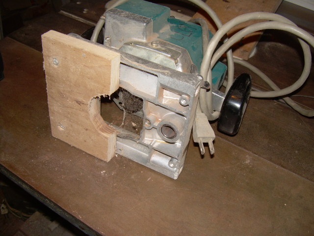

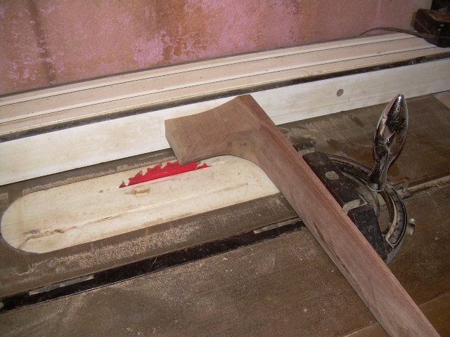

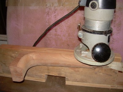

Postby Clay Schaeffer » Fri May 04, 2018 2:29 pm
If you are just looking for a way to quickly rough out necks here are a few simple techniques you might consider.
1. Use a router and a large round over bit (steel string) or bowl bit (ovolo - classical shape) to hog off most of the material using a quickly made jig.
2. Use the tablesaw and miter gauge to rough out the "Spanish heel " shape by carefully moving the heel across the blade.
3. If routing a blank with an integral peghead use a thick subbase with one side cut away to allow the base to clear the peghead (this will also "sculpt" the transition area)
