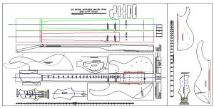

The plans used for this bass were drawn by MIMForum member and teacher Bill Moll for our online bass-building course. We know a lot of our members have produced beautiful instruments from his plans, so we used them for our MIMForum Bass.

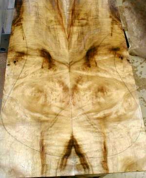

All the wood for this bass was donated by MIMForum member Larry Davis of Gallery Hardwoods, and the work on the body was done by Dale Belcher. Take a look at that beautiful figured myrtle top cap! The body is made up of layers of myrtle, ebony, bubinga and black limba, carefully chosen by Larry for the best match.
